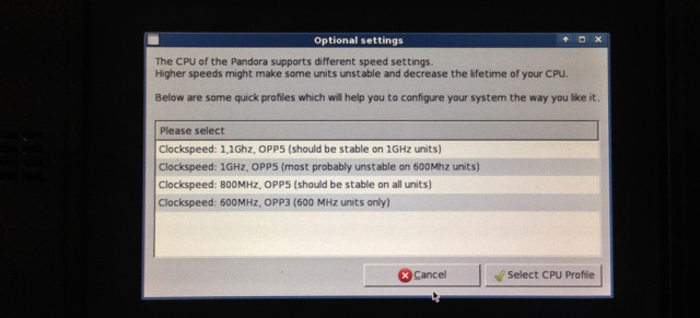

6. When I first turned on the unit and went through initial setup the CPU profiles settings are all at OPP5 except for last 600MHz option.
I'm currently at 1GHz OPP5.
I'd like to change to OPP3 1GHz i.e. no overvolting. Is this possible how?

6- 1GHz units do OPP3 and OPP4, not OPP5. Yes you can OPP3 1GHz, it's in settings menu->cpu settings.
I've only got the following profiles no 1GHz OPP3 profile.
How can I customize this list and add it?
Would like to add others too i.e. 1.2GHz OPP5

Try setting the max OPP level to 3 then set the clock speed to 1Ghz.
