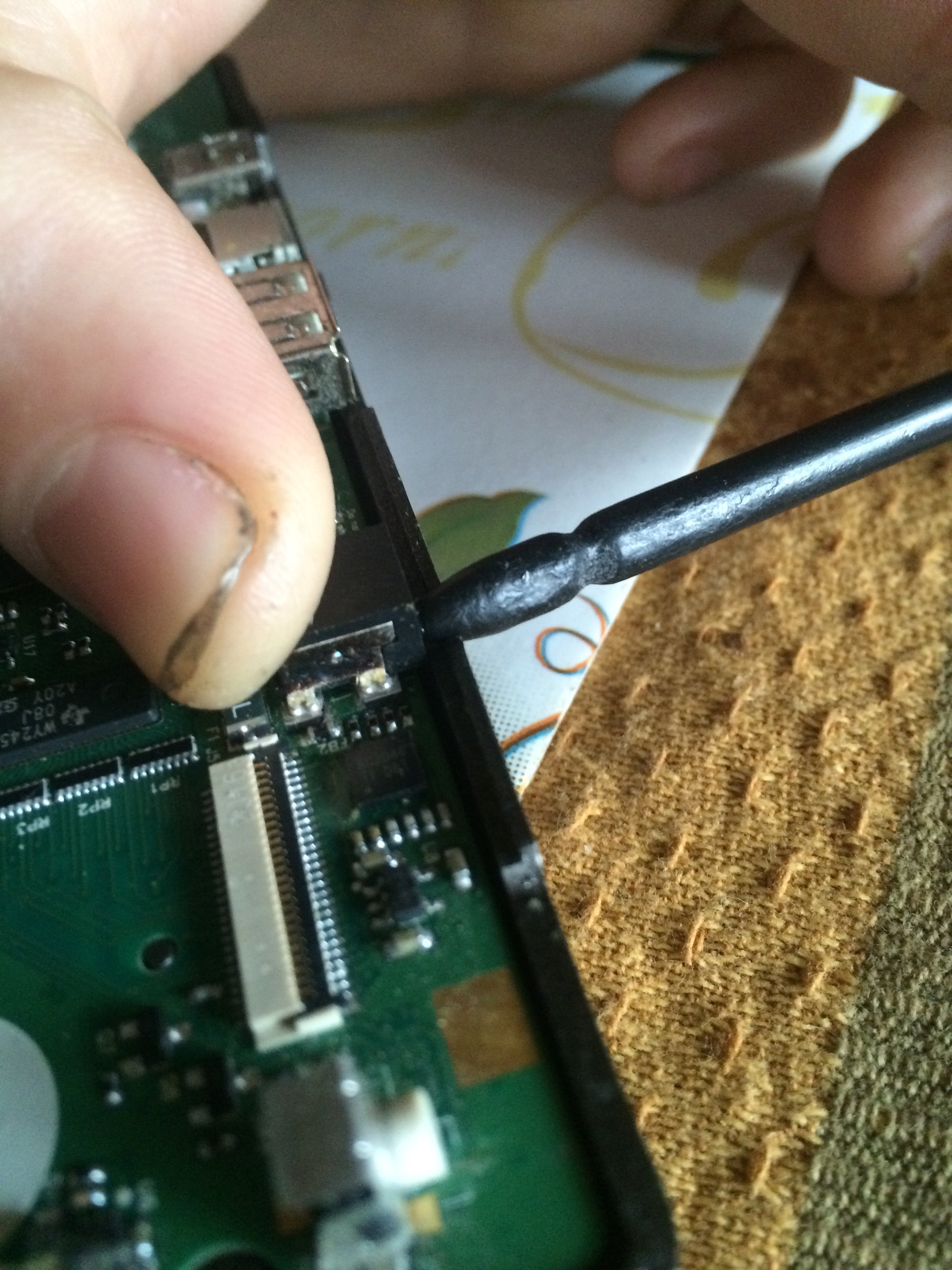

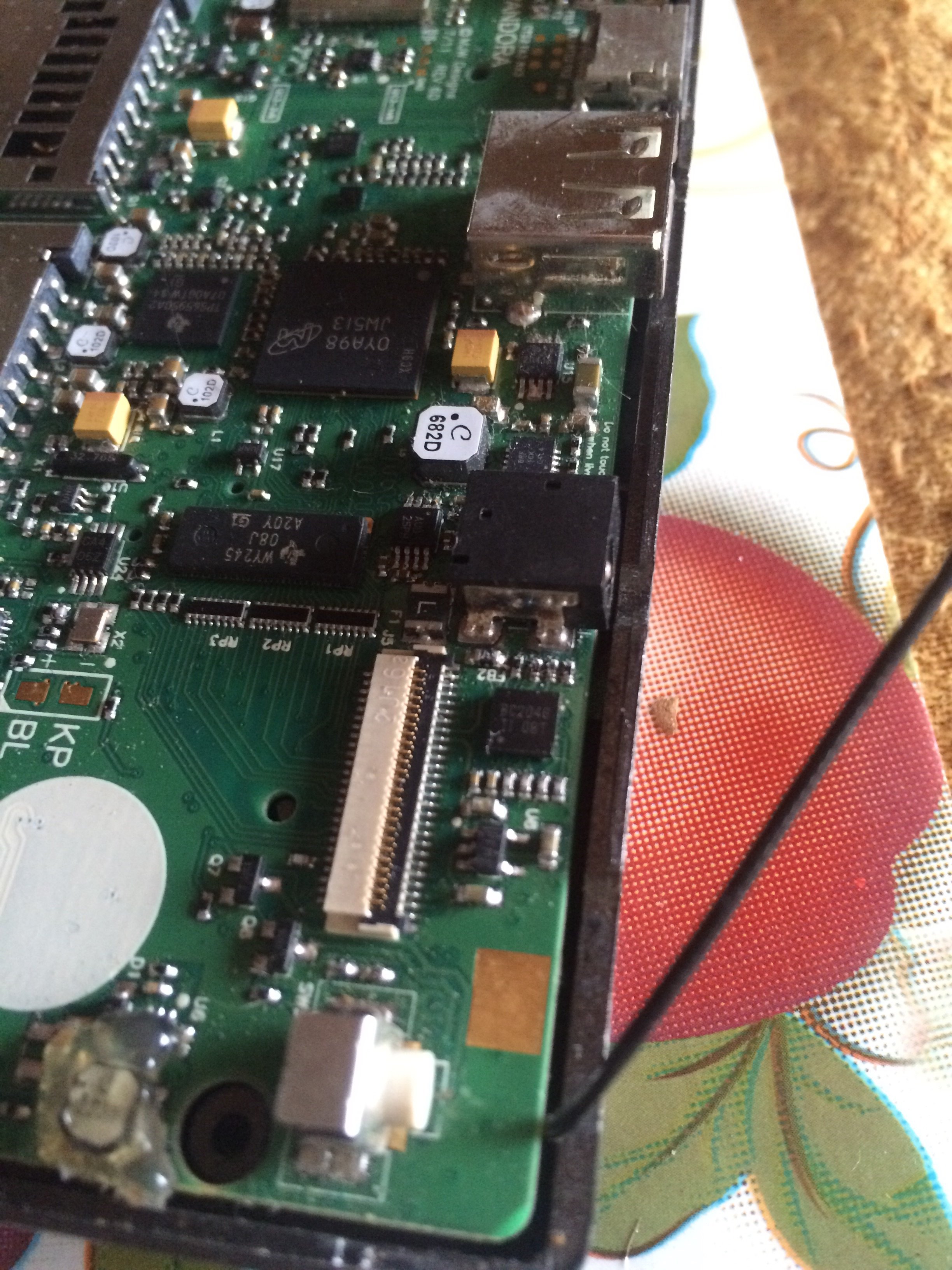

I know this is a hardware issue because of openning two of them and seeing the charging port loose and the contacts separated from the board.
One of them has three contacts and it's pads torn from the board, one has two contacts loose but one them broke in half and half of the pad is still Attached to the board.
The third one I suspect one or two pads are doing the exact same thing mentioned above.
Is this something I could fix or are these boards screwed?
Only one seems to charge over USB the others refuse to. Hence why they're disassembled in a box I'll see if I can upload a photo of the boards
Here's the one with 3 contacts broken
Here's the one two contacts broken. The third one I have gotten to charge over mini usb for tonight so I'm not eager to strip it apart.. Again.
Well if some of the pads are still left on the broken contacts, then yeah It should be just a matter of resoldering them again to have a good connection again.
Just to be blunt, do you have a habit of tripping over charger cables? or something odd causing a lifting, pulling or pushing action on the Charger jack when it's plugged in?, only way I can see how three devices getting broken like this in a similar manner is if the ports suffered the same kind of action which damaged them.

Looks like it's just going to be a simple re-solder fix, as tripping over would crack some of the small contacts and possibly bend it upwards.
