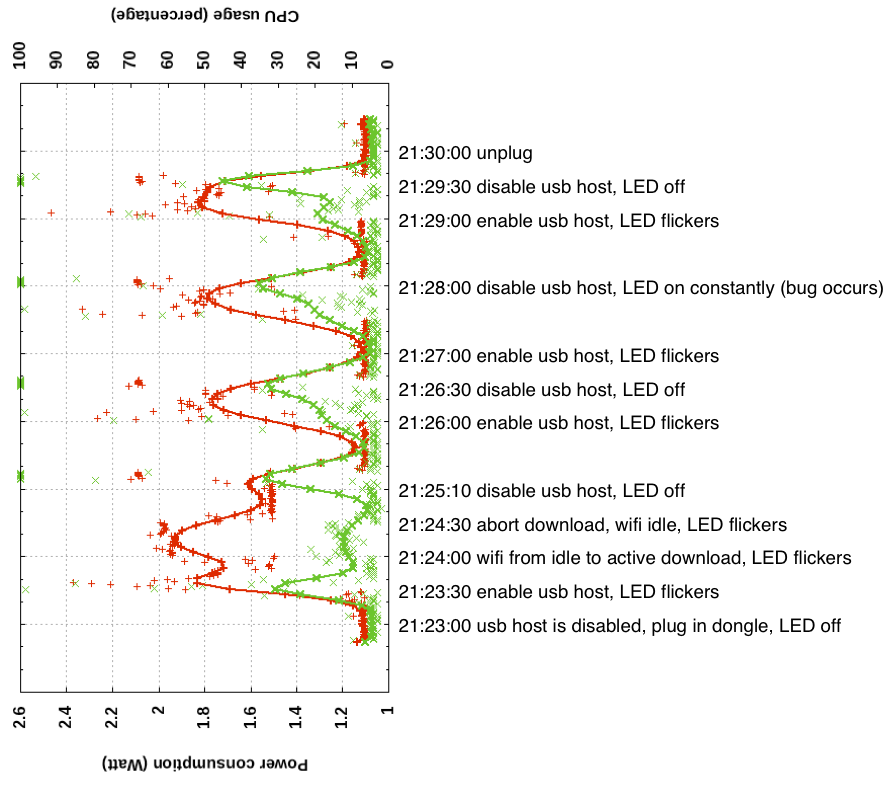

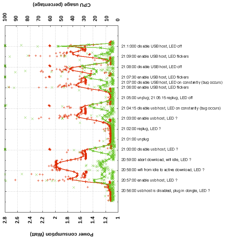

Really??? I always left my USB WiFi adapter plugged, and assumed the USB port is completely shut down if USB host is disabled and that the device only starts consuming power if USB host gets enabled, the port getting powered only then.
And I did 2 test runs and monitored with sysinfo, and my assumption was proven right!
openpandora--usb-host-on-off-1.png openpandora--usb-host-on-off-2.png openpandora--usb-host-on-off--logs+plots.zip
Note: To read that graph chronologically, you must read from bottom to top.
Could not do it better, sysinfo does yet not support timed comments, I had to do that manually.
Graph interpretation: The baseline for the power consumption in state "unplugged" and "USB host disabled" is the same! Except if the bug occurs (LED on although USB host disabled). In that case, the consumtion is higher.
