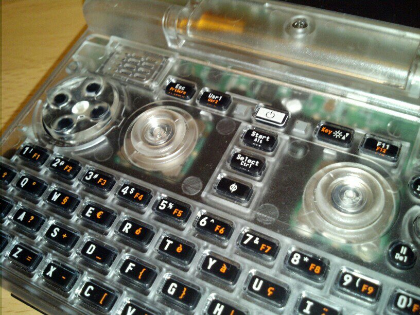

So how well does the case work?
Overall, I'm pretty happy so far.
The nub discs work perfectly, and even though the nubs themselves are a bit noisy (you can sometimes hear the springs moving inside), they feel great and moving the mouse is just awesome!
Every key of the keyboard is easily reachable, thanks to the rounded corners, the Pyra is comfortable to hold, the DPad works great.
I can't wait until all the tweaks have been finished.
What's great is that you can easily unscrew and open all parts. You can access the LCD and display board without the need to open the base part and vice versa.
It's very repairable and moddable, which is great!
Here's a picture of the DPad and nubs, in case you haven't seen it on Twitter yet:

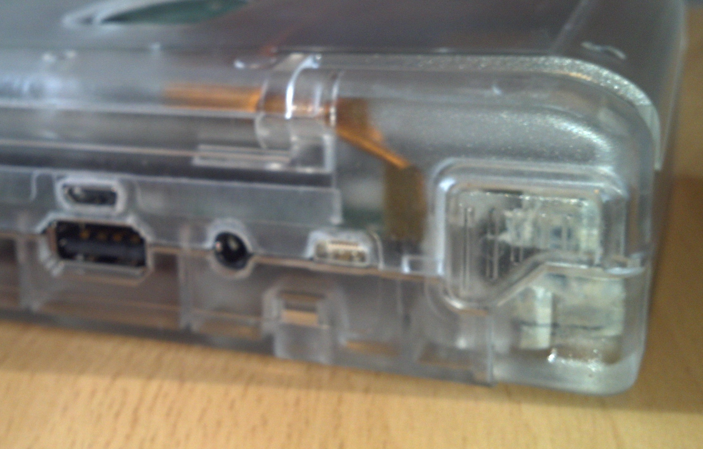

2. Finalizing the LCD Cable
The current LCD cable works fine but it is too short and therefore damage to the cable will happen eventually.
You can clearly see that on the picture (and now you know what a transparent case is useful for!)
Now that we got the real case, we could create some more paper dummys and finalize the LCD cable design as well.

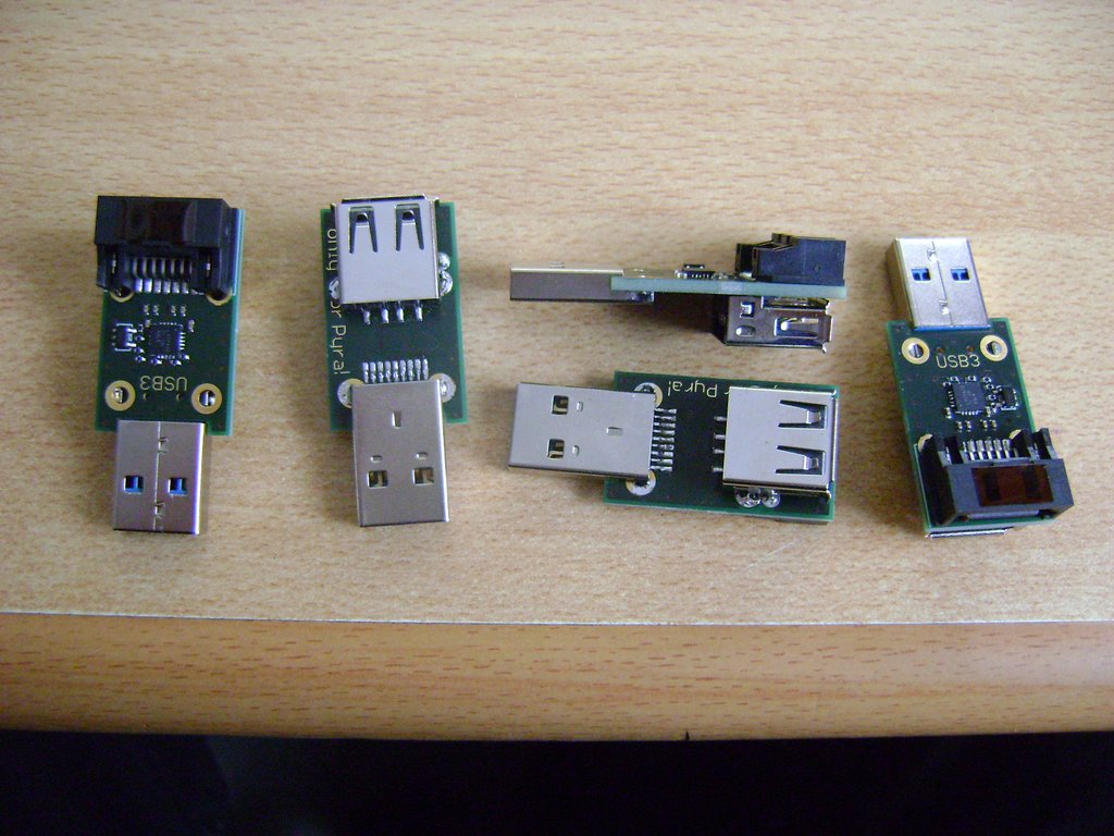

4. Finalizing the PCB design
Last week, Nikolaus has worked on the whole battery charging circuit and already made a few small improvements to it.
We will probably also replace one charger chip, as the current one can only handle one charger port input, but want that you can charge through both MicroUSB ports so you can use the other one while charging.
He also built prototypes of the S-ATA adapters, which will need to be tested.
The PCBs are working really well now, and most of the remaining work is software stuff. Nikolaus worked on the SSD kernel driver and seems close to have it finished.
