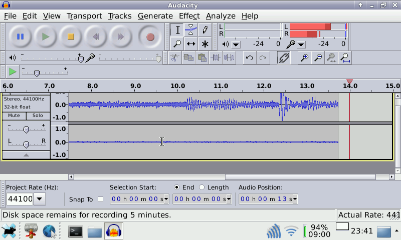

Ok, so I tried to get recording to work... without success, so far. Can this use the Pandora's inbuilt mic? Is the xfce mixer the one that's on the taskbar? If so, how do I select an input device? I don't see an option for it.
I also tried to connect a Zoom H2 recorder by USB, but the Pandora didn't recognize it. I had really been hoping that I'd be able to use the H2 to do some multitrack recording in Audacity.
hi
in mixer controls choose 'select controls' and then tick 'left input source' and 'right input source'
thne in the main screen you should get a new tab called 'options'
her now choose for left inpout source - main mic
and for right input source - line in
the recording does not do proper stereo and there is a lot of noise
Thanks a lot peelie, I got it to work by following your instructions. It actually sounds pretty good to me - not too noisy. The sensitivity seems to be set very low by default... do you know how to raise it?
I'm not surprised by the fact that it's not stereo - after all, the Pandora's mic is a tiny hole in its case. I just set Audacity preferences (in Edit) to record mono.

recording sound worked for me after I increased the buffer from 100ms to 1000ms and setting the latency corretction from -130ms to -1300ms (I just added a zero each, no idea if these settings are optimal).
Before changing that, the recording only worked for like 9sec (33kbit, mono) then suddenly stopped.
I can also change focus, close the pandora lid and use other programs without disrupting the recording!
