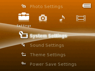

DinguXMB v1.0 - "A Cross Media Bar for the Dingoo A320"
Alternative Frontend and Application Launcher.
Port by Slaanesh continuing work from BooBoo's original port of GP2XMB.
See the README.txt for details.

DinguXMB looks and sounds beautiful, I think it has some potential. Still, there are rough edges everywhere and I hope I can help with naming all glitches I found:
1. Most important to me: Adding elements on the go to the shortcut-list is a nice feature, but I actually always liked the attempt to split those elements in dmenu, so something like "add to apps" "add to ports" "add to emulators" would be very much appreciated. I'd think that system could be made pretty dynamic over time, with features like adding new shortcut-submenus oneself.
2. Elements that could/should be disabled for now:
-In Settings
--Video Settings
--System Settings
--Power Save Settings
-Video (probably until someone ports mplayer or something compareable)
also, the "build-in-memory-buttons in Photo, Music, Video and Games could probably be disabled for a while.
3. snes9x, doesn't work because of missing file-browser
4. Hatari, nofrendo, sdlgnuboy, smsplus broken for some reason
5. restarting in 5 seconds... any reason for the delay? dmenu was always right back.
Somehow dmenu feels a lot more "mature" now, while dinguxmb seems to have a lot of potential.
