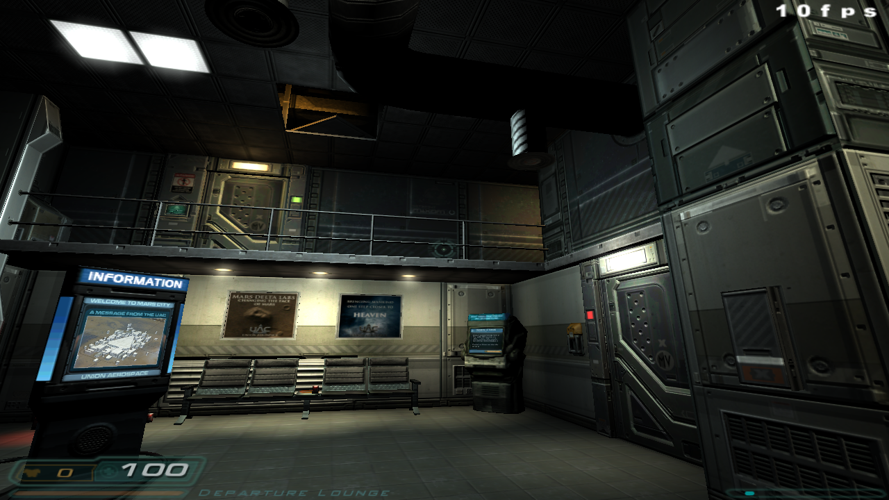

So, I have uploaded an updated version of doom3 dbp. This version feature a faster build (using lto), but the main trick is thta is does all the game rendering in a small FBO (at 853x480, so not too small), than blit&scale that to the actual screen.
It allow better FPS because the main rendering is done in a smaller size, but also allow Gamma/Brightness to applied when blitting. The trade-off is a bit more pixalated rendering, but it's not really noticeable with the small screen size of the Pyra. I could enable shadows without the game slowing down too much.
There are still some places were the fps is low, but I think this is just because there is a lot of geometry to draw. Perfectly playable anyway at this fps IMO.
