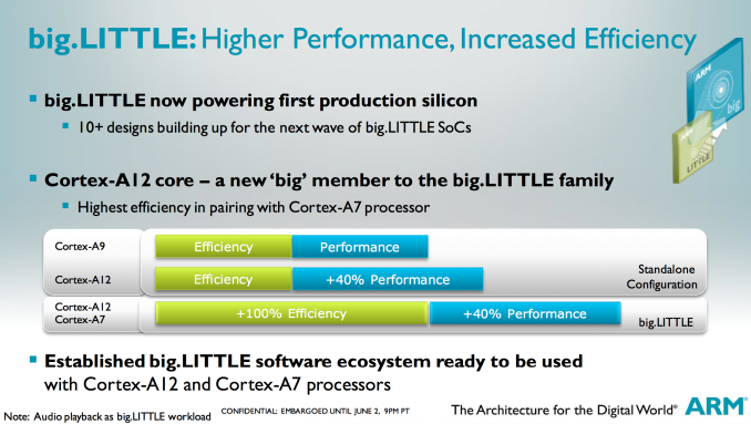

Something like that Rockchip would be a much bigger improvement, not just because the GPU has FOSS drivers, but also because the lower node size means it will have better perf/Watt, and its ability to use DDR3 means better RAM speeds are possible.
you sure it has open source drivers, or is it only partial with big nasty blobs? xD that'd be so cool but somehow hard to belief
A Pandora with DOSBox emulation, for example, would use the CPU for extended periods of time with high load.
then the wait for a big.LITTLE with A12 cores instead of A15's might be worth it

If in some way ED manages to get a big.LITTLE SoC from Samsung, then please make sure it's the Exynos 5420 and not the 5410. It looks like the 5410 has severe issues that essentially mean you don't get any of the advantages of big.LITTLE, and supposedly these issues are fixed in the 5420. Also, the 5420 uses a Mali GPU instead of a PowerVR, which is better for performance and for FOSS driver support.
WizardStan
Mega GP Mania
May 24, 2008
16,731
Personally I boubt the need of 8 cores. 4 cores (2x A7 and 2x A15) would be enough. You simply can't parallelise everything
You don't get all 8 cores at the same time, it switches. So a 2x2 would only be dual-core, automatically switching between efficiency and high performance as needed. Dual-core is a step up for the Pandora, and big.LITTLE light years ahead, but still not as big an improvement as we could get. If we could get a 2x2 where all four cores could be used at the same time that would be awesome, but as far as I know such a thing doesn't exist. There's recently been a 4x4 that can use all 8 at the same time, but ED's probably not going to get one of those any time soon :p
