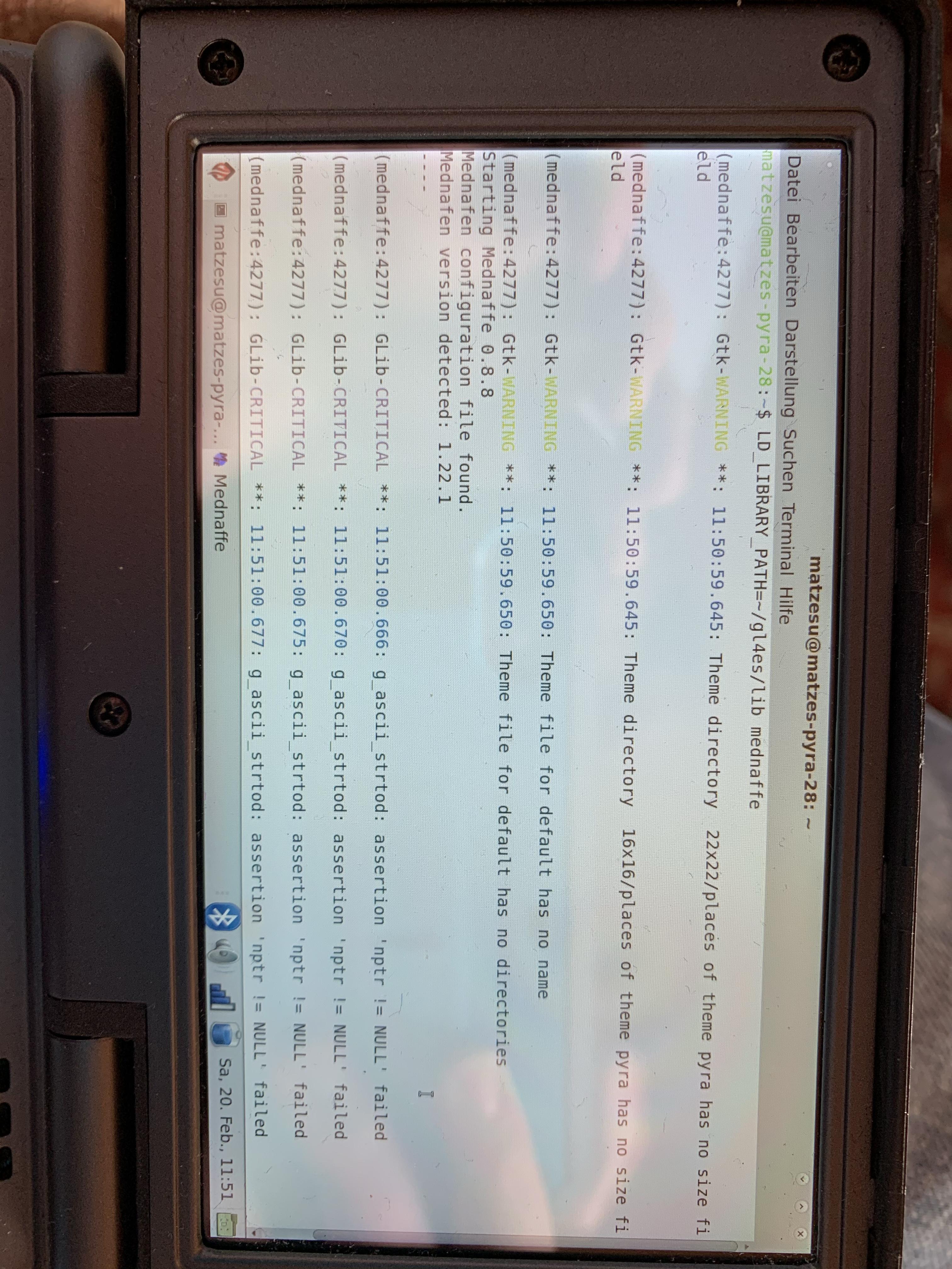

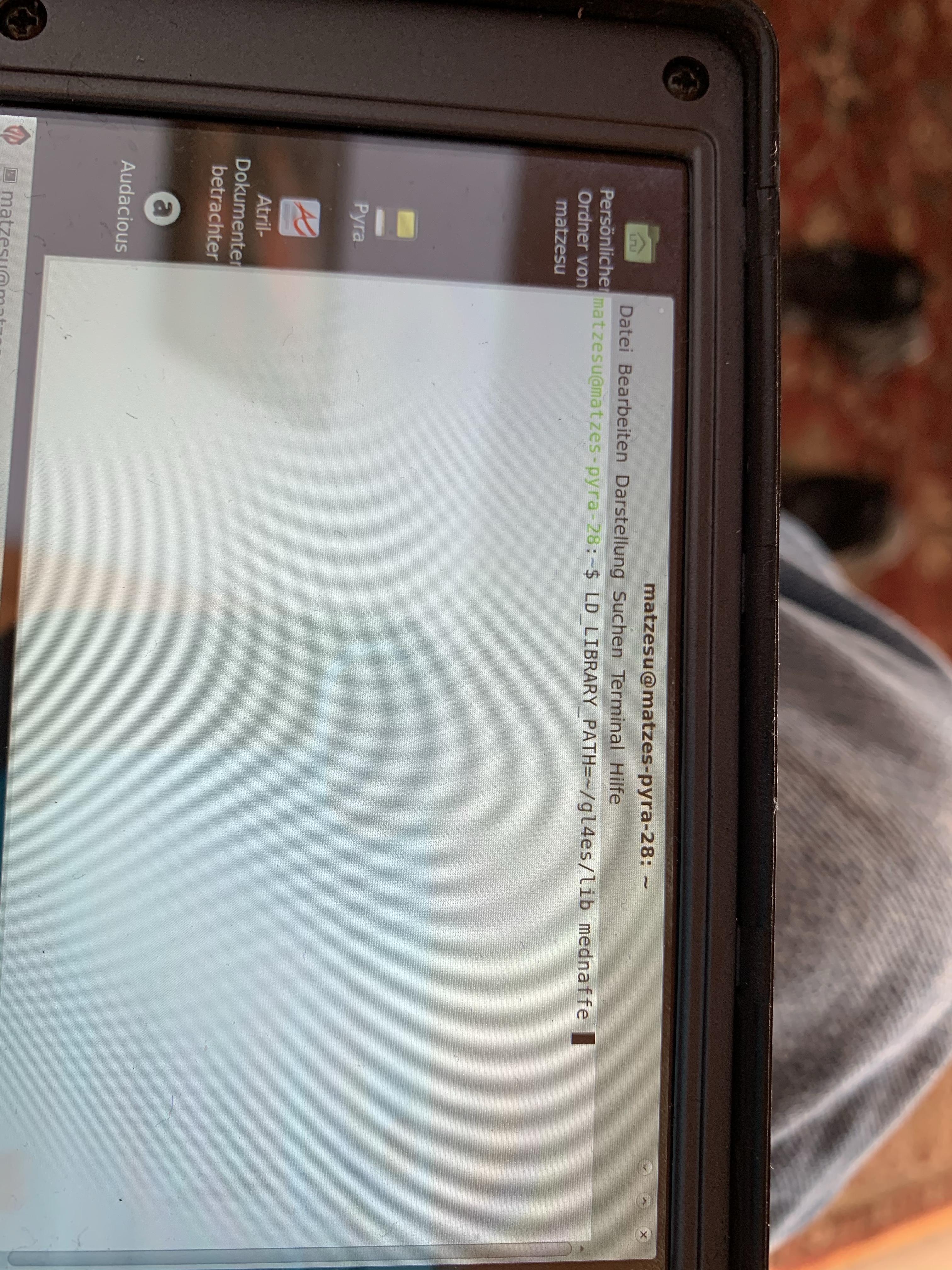

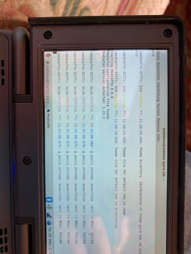

When I run mednafen whit the Gl4es command, it’s gets some issues
matzesu
Forum Addict!
Staff member
Oct 24, 2008
11,098
36
Germany,, Saarland, at home
At least it’s opened up the mednafen, but it’s doesn’t run any games ..
i used the command from the fubillard + from ptitseb because I thought it might work this way
Maybe there are some libraries missing? Like on Muppen bevor Wally fixed the dbp?
