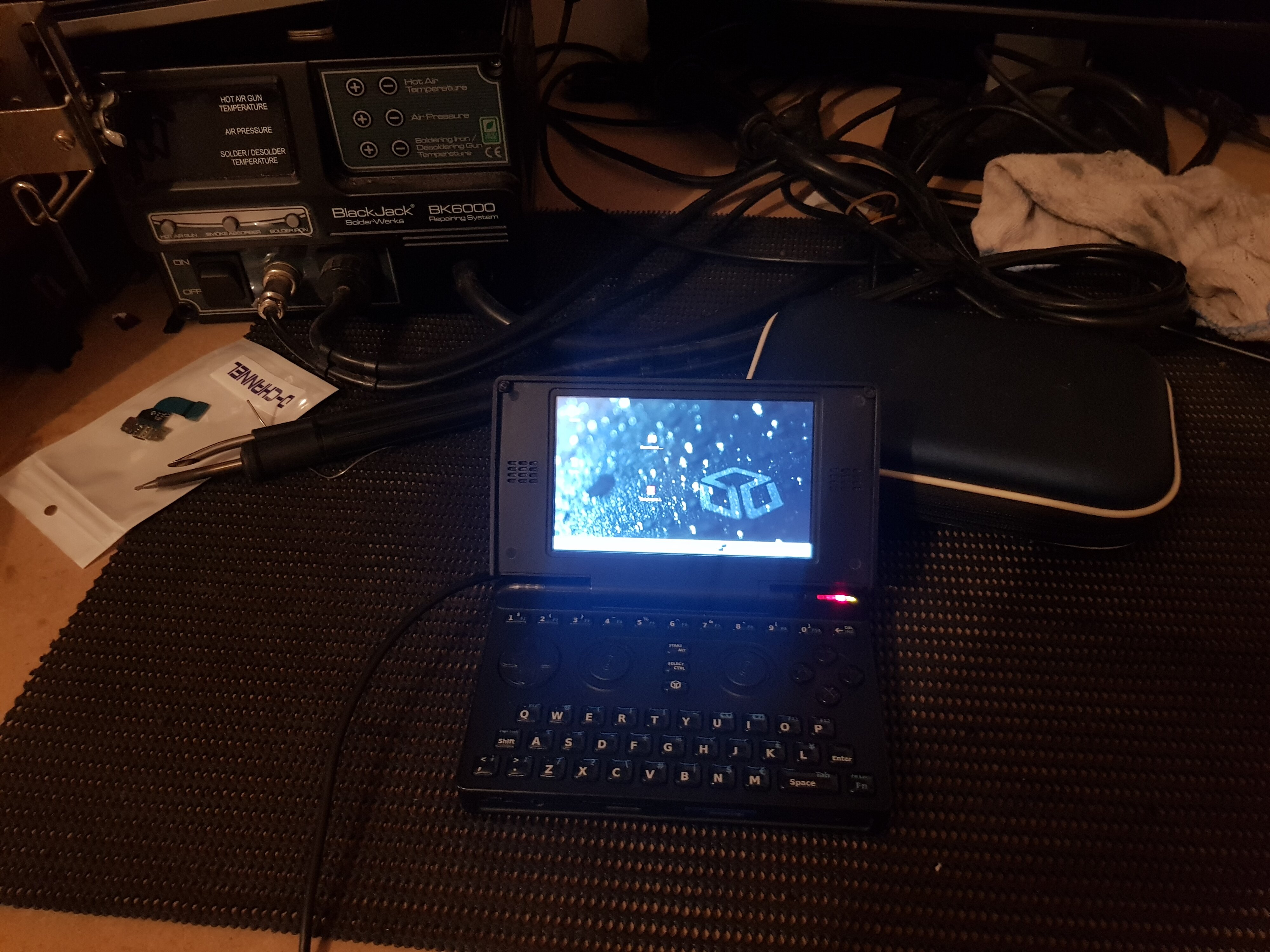

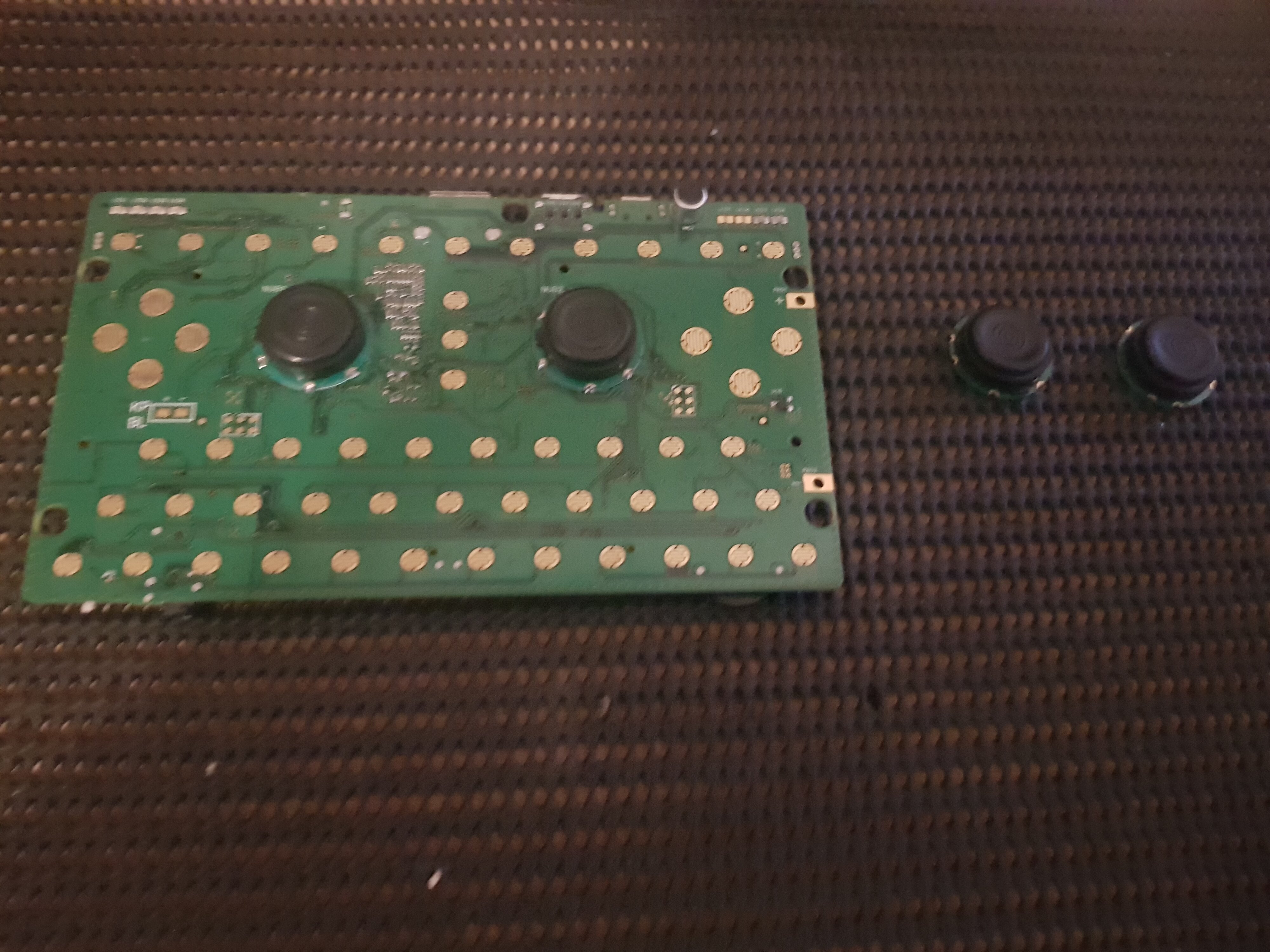

They have had faulty nubs since I got it. Evil Dragon very kindly sent me some in the post for free. 6 years later I am getting around to installing them.
It was a little tricky but going very slowly is the key.
They work lovely now with rev 2.0 nubs
Today is a good day for my Pandora console.

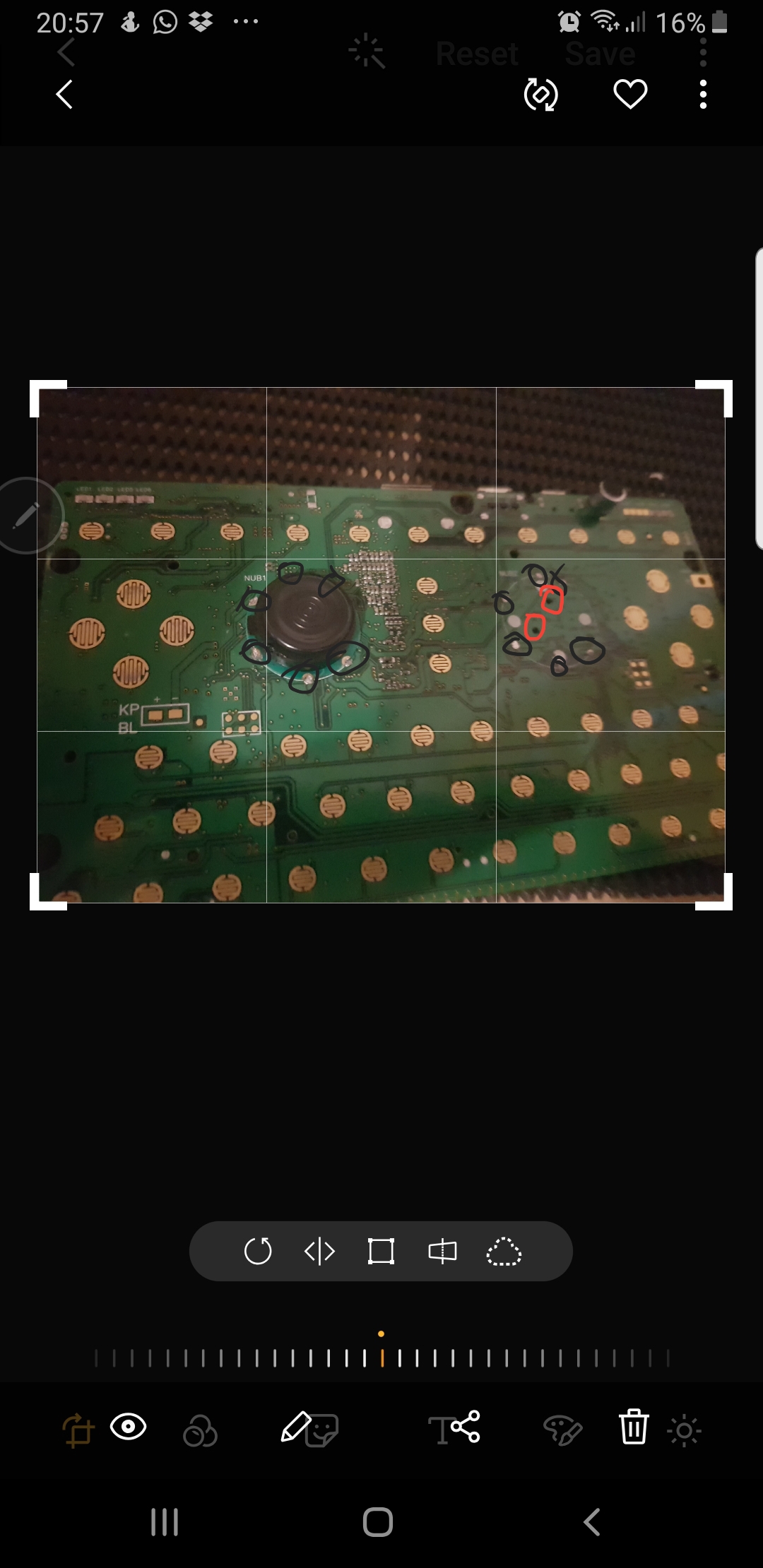

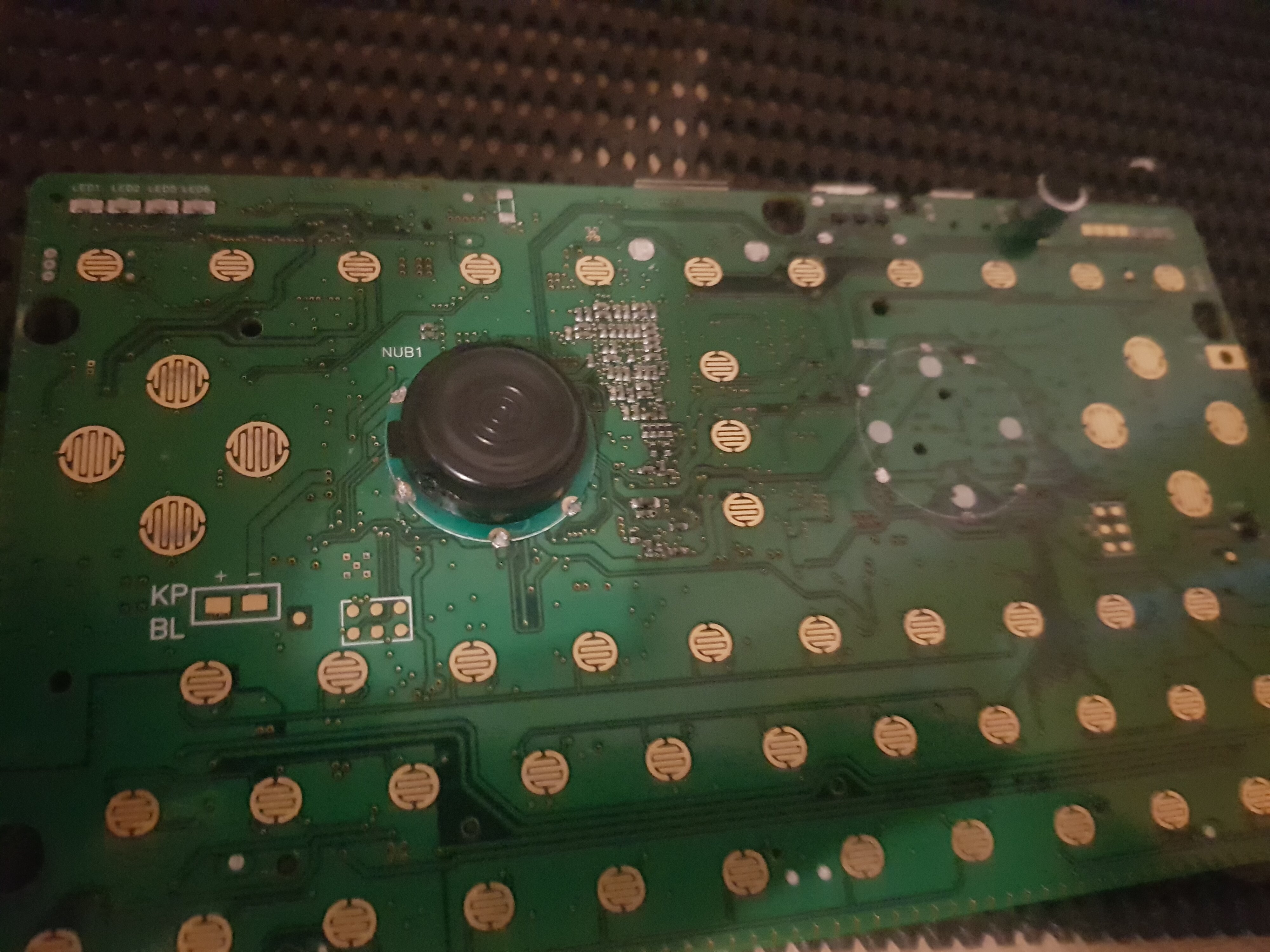

I don't think I've ever seen under a nub before. Are those four silver surfaces contacts (although I can't detect any lines going from them, which is odd) or stickers protecting the surface or something else? I always assumed the six solder points were the interface between the nub and the CPU but maybe they're just there for mechanical grip.
The red circles line up with dimples on the nub for orientation. Then the 6 black circled pads surrounding the edge of the nub are the solder points. The nub is held into position by these 6 solder points and is also reinforced with the case as is quite a snug fit, not sure if conducts via the solder points or the 4 points underneath.
Post automatically merged:
Edit: underneath the old nub is 4 screws that roughly line up with the 4 pads underneath, but contact would be poor at best so I am going to guess they all ground and the solder points are the data lines plus extra to make sturdy.
