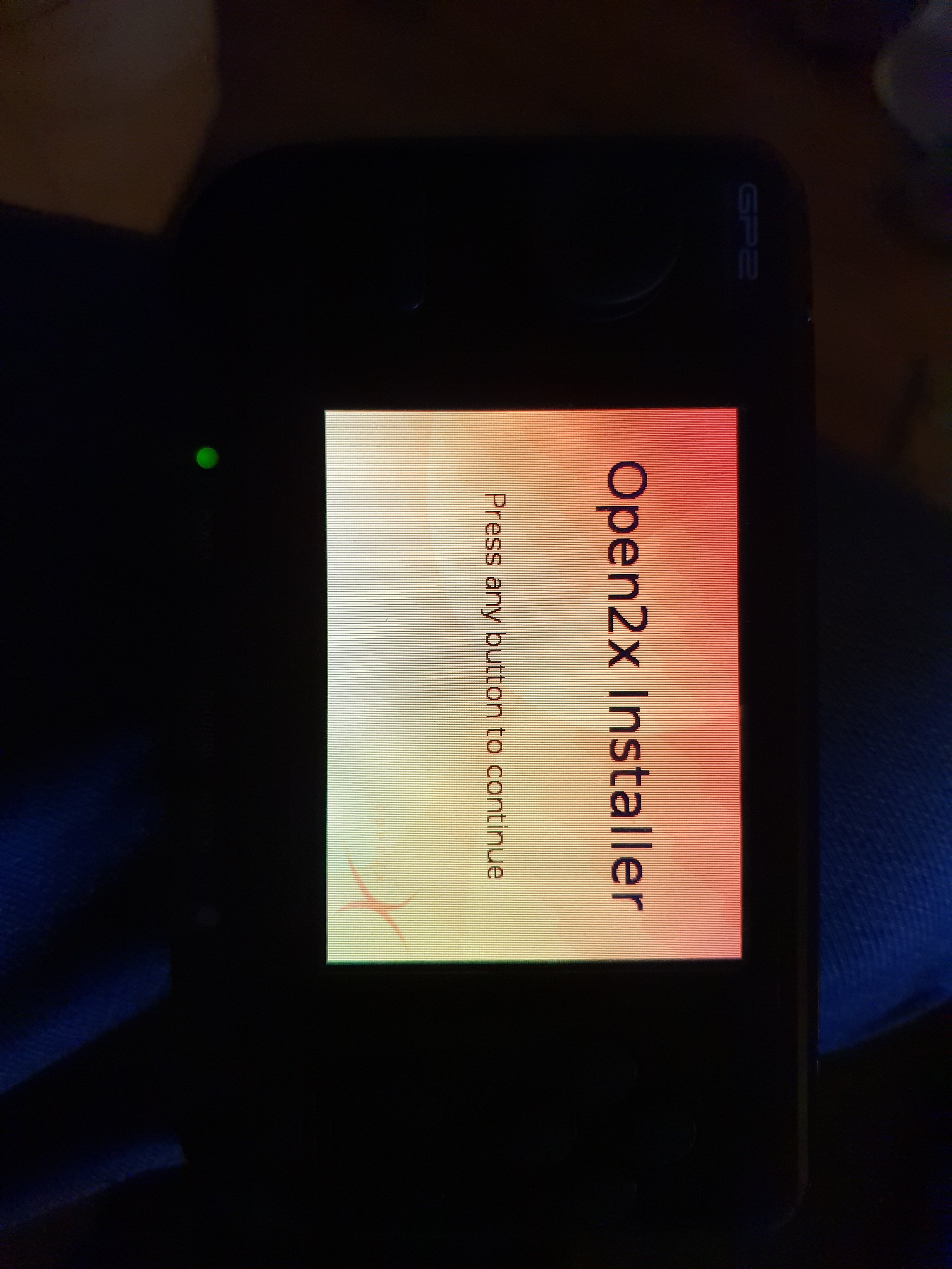

    Ok, mystery deepens, found another old SD card, and again the only thing that will boot is the 3.0.0 firmware, the NAND blanker doesn't do anything and neither do any of the other firmware. Am I missing something obvious to trigger booting from SD? I'm holding start and select before switching on, then not letting go, it does the black logo then the green 2.0.0 loading screen then goes to black. Is this the right way to do it?
    Thanks
  7. Tachikoma
    Tachikoma Newbie
    Joined:
    Dec 3, 2018
    Messages:
    9
    I think we have a winner!

    So all back up and running with a 32GB SDHC card, for reference, I will link the card that worked. Got another 3 coming so will test those and report back. If anyone else finds themselves with a semi bricked F100 hopefully this will help if they find themselves without a card or only a SDHC and can't boot from it.
