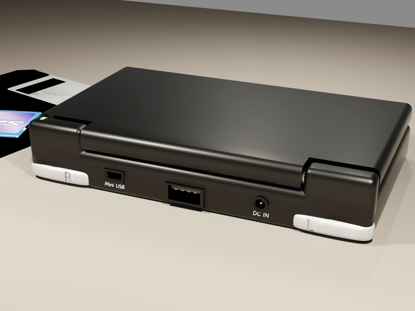

Couldn't video, microphone, and Uart, by adaptor, be used in the back external port: http://www.gp2x.de/images/temp/pand080208_2.jpg
Video out coming from the back would be the most practical though, if do-able. :unsure:
That's not an ext port, that's a USB port.
Oh, so the device has both a mini-usb and a regular usb. Thanks, didn't know that. :)
