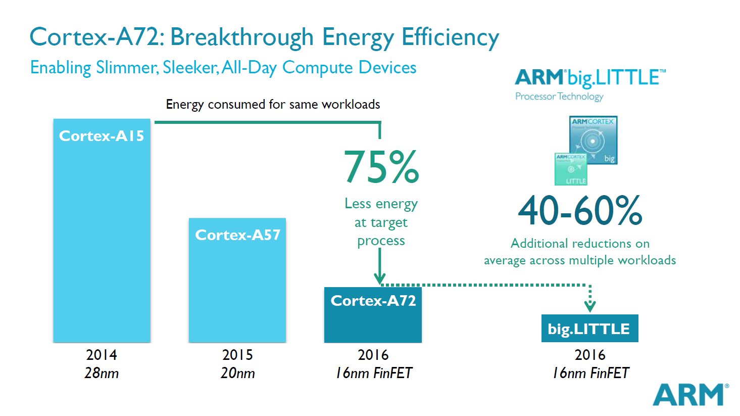

So, in 2014 ARM released the A15 (28mn) technology. Which was available one year later to non-insiders. Look at the power reduction...

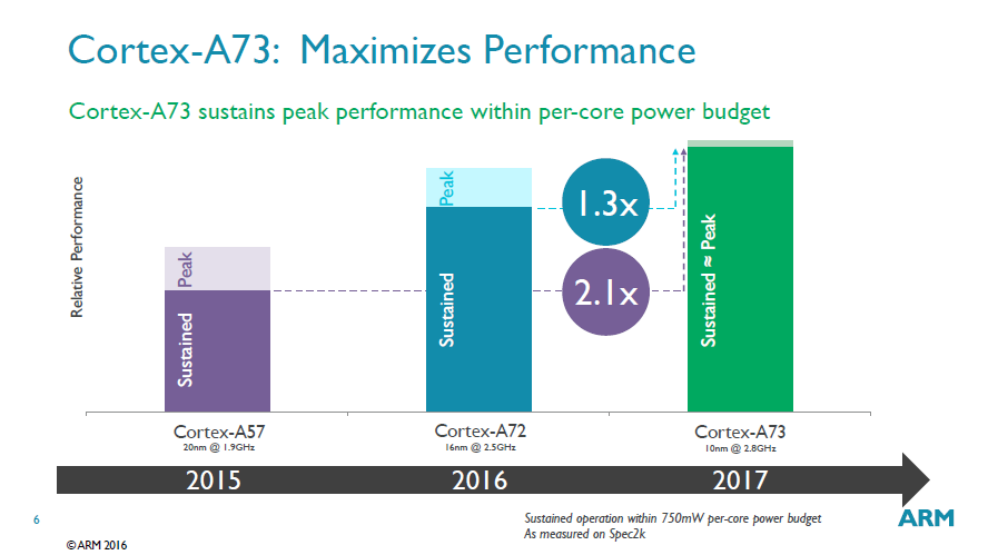

And now, in 2017 Artemis arrives on 10nm, and look at the sustainable burst:
Smaller chip means less power and means less heat.
However: not all is gold there. They changed the 3D from Mali to Mimir (which probably means incompatibility once the daughterboard is replaced... until the software catches up.)

Yes, new size reduced parts are always more expensive to make, because yields tend to be low until they can figure out how to do the lithography better. Presumably we're well into the scope for quantum tunneling and things to mess everything up, but I haven't heard about that for a few generations so I don't know what they've had to do to get around it, although that would be initial R&D cost and be peanuts compared to that lost through duff printings. In the long run they're cheaper because they can print more parts on the same wafer, although I guess that's more a benefit for big chips like x86 chips.
I'll also mention that 750mW/core stat they're using for the graphs in the second diagram looks kind of high to me. A phone/tablet/pyra type thing won't be able to sustain that across quad or even dual cores for all that long I'd have thought.
