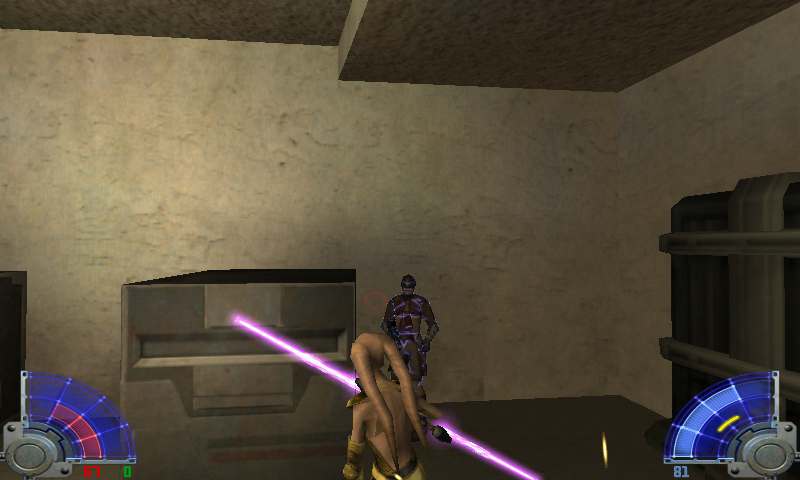

Here is the Full version Jedi Knight 3: Jedi Academy.
You need Data files to make it runs. Install Full (or Demo) version on a PC or using Wine (no need to update to v1.01) and copy the "base" folder to your appdata/jediacademy folder.
If you don't own the full game, you can try the Demo version, Ready2Run here. If you already have the demo, you can use the full version that also support Demo data.
The Demo feature 2 levels from the full game, but you play them with more advanced powers (mainly for the Moss Esley level).
This one share a lot of code with Jedi Knight II, so I mostly repeat what's on JK2 thread.
