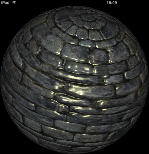

update: done. screenshot from the GL ES2 testbed app, run on an actual SoC hw:
(I have no idea whom to credit for the model - I stumbled upon it on the internetz and thought it was pretty, so if somebody knows the origins of it - shout)

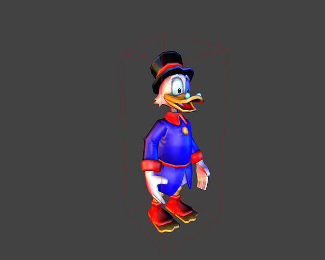

Dragons_Slayer's great Scrooge McDuck model from the 256x256x256 thread:

as promised, some results from other platforms. here comes the ipad (os 3.2):
gl vendor, version, renderer, extensions:
Imagination Technologies
OpenGL ES 2.0 IMGSGX535-38.10
PowerVR SGX 535
GL_EXT_blend_minmax GL_IMG_read_format GL_IMG_texture_compression_pvrtc GL_IMG_texture_format_BGRA8888 GL_OES_depth24 GL_OES_fbo_render_mipmap GL_OES_mapbuffer GL_OES_packed_depth_stencil GL_OES_rgb8_rgba8 GL_OES_standard_derivatives
GL_MAX_TEXTURE_SIZE: 2048
GL_MAX_CUBE_MAP_TEXTURE_SIZE: 2048
GL_MAX_VIEWPORT_DIMS: 2048, 2048
GL_MAX_RENDERBUFFER_SIZE: 2048
GL_MAX_VERTEX_ATTRIBS: 16
GL_MAX_VERTEX_UNIFORM_VECTORS: 128
GL_MAX_VARYING_VECTORS: 8
GL_MAX_FRAGMENT_UNIFORM_VECTORS: 64
GL_MAX_COMBINED_TEXTURE_IMAGE_UNITS: 8
GL_MAX_VERTEX_TEXTURE_IMAGE_UNITS: 0
GL_MAX_TEXTURE_IMAGE_UNITS: 8
test was run on the complex shader alone, and there it yields:
at 256^2 - fps is 44.
at 512^2 - fps is 11.4.
as one can notice - almost ideal scaling with resolution. which means the test is absolutely fragment-limited on the ipad.
a thing to note in the extensions string is the absence of fp32 support in the fragment shader, so chances are it's doing fp16 (versus fp32 on other platforms, pandora included), but i've not bothered to verify that.

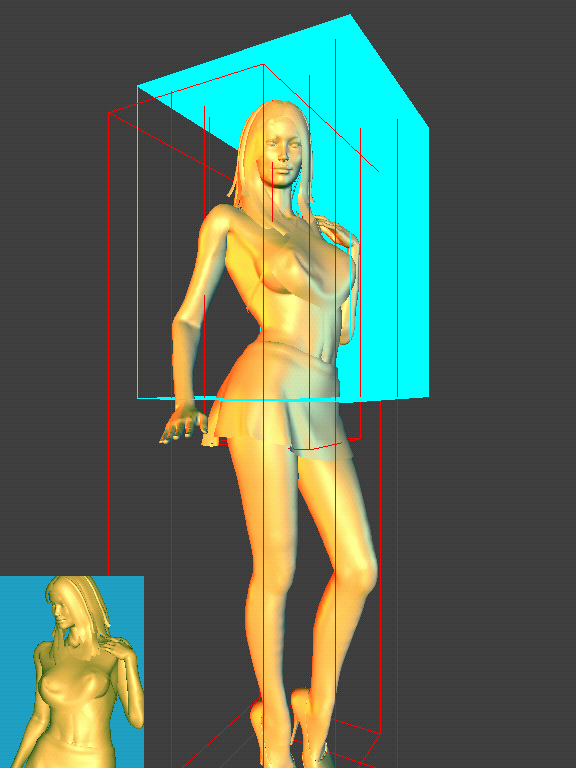

The Ahmed_GEO.age file gets slightly better - in that it also renders a red box outline. The shader fails with:
Code:
program 'phong.glslv normal_direction_renorm.glslf': missing vec4 parameter 'lp_obj'

This looks more or less correct now, except that from what i can tell from the shots, meshes all have inverted culling. Could you, please, try the following:
* run the testbed app with ./assets/girl.mesh and options -other_up -invert_cull
* press 'p' once, switching main view to using phong shader with a single light source
At that stage, both the main view and the sub view (lower-left corner, showing output from the cyan camera) should show the model with one light source, positioned at the viewer. You can then use the [`] (accent) key to toggle the polygon culling at runtime, and see if the mesh toggles between 'unlit' (i.e. facing away from the light) and 'front lit' (facing the light at viewer).
ps: the screenshot in the first post of the thread is how the girl model should look with proper culling and 3-light phong in the main view, 1-light phong in the sub view.
pps: testbed RuntimeControls here.
