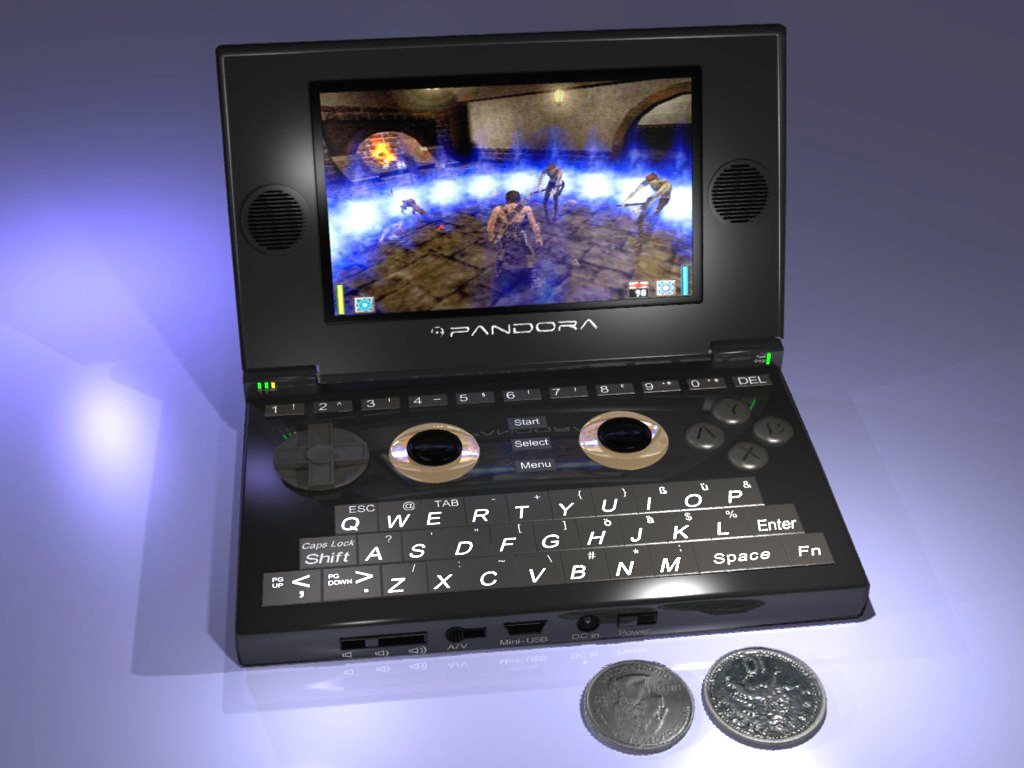

at last your comparing the actual product to the advertised renders, and the one thing you find disappointing about it is the angle it viewed at
how about, the hard kaypad (not thumbpad)
how about the fact some of the early models looked a lot better, silver etc around nubs, logos, silkscreen
or the fact that psx4pandora was shown on one and wasnt released
my favourite render was this (although i prefer the keypad of the on underneath)
also the viewing angle was shown like that because otherwise you wouldnt have seen it

About the hinge mechanism:
The actual mechanism is a cartridge inserted into the plastic of the case. We could not afford to design and manufacture our own, we needed to buy one. The reason this is the way it is is because that is all we could find to work in this size unit. It only has two detents, one open, one closed.
The DS has three, one open, one at an angle and one closed. We would have liked that one too but the company that makes these hinges (there aren't many) said NINTENDO had exclusive rights to that hinge and we couldn't buy the same one from them. We buy from the same company Nintendo does. We would have to have had a custom hinge mechanism made with more detents for more positions but not infringe on Nintendo's design. Of course then the tooling would be costly and the lead times would be much longer to get (more delays).
I like to think of it like this, pretend it is like a PSP go where the screen slides up (no angles) with the added bonus that it closes like a clamshell and can stay open at an angle if just watching videos.
