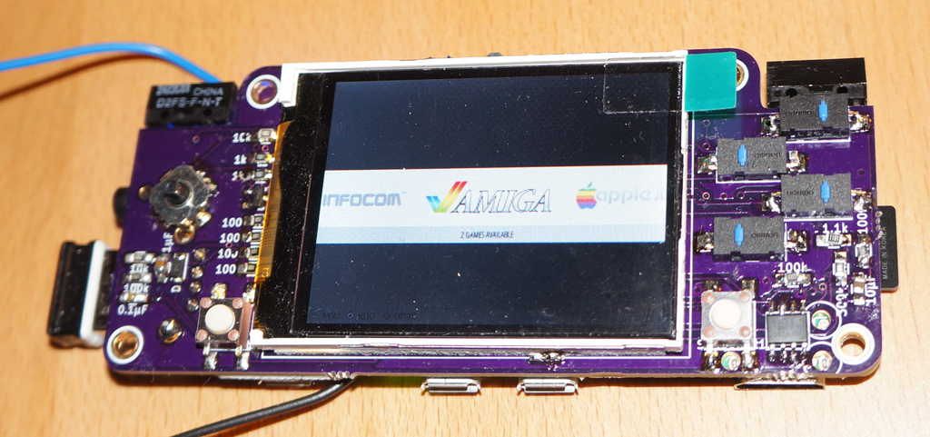

Ok, some news... I finally received all, including a flux pen that I forgot at first, having never done smd by hand... Solders are far from stellar but all seems to be ok, no cold joints or shorts. So far I have only been able to test the soft power section (and the pi but that is expected to work...) as I don't have a SD card ready to test the screen or the audio out. I suspect I have neglected the software complexity too...
Ok, I was able to use the image for the pigrl zero from ladyada... I was able to boot and see the screen. But I wasn't able to progress further, I need a keyboard and I noticed one of the pcp-on-pcb contact failed. It's one of the D from the full size USB plug... Nothing too bad but as I don't have a usb otg adapter I am stuck at this point, I'll try to fix that and post pics tomorrow... Looking emulation station on such a small screen is great.. But upside down for the time being. That was quite expected, once I'll get a keyboard on I will need to find out how to fix that, lol
ok, USB in fixed, screen rotated:
I'm afraid I might have placed the alps joystick in reverse, but I need to check.
I also think I will need to drop this retropie setup as it do not support wifi and bluetooth on the raspberry pi Zero W... and restart from a more modern raspbian and install all the pitft and retropie over it... seems not easy and long...
