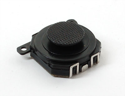

What do we think of the current nubs? Are there other options?
https://www.adafruit.com/products/444
This design is friendier but the case won't be able to close as a clamshell.
http://shop.pimoroni.com/collections/kits/products/analog-2-axis-thumb-joystick-with-select-button-breakout-board
Current nubs are fine IMO but a rubber coating would be nice for added grip. Something along the lines of the 3ds nub would be awesome.

The, supposedly, p2 nub I laid my finger on doubles as a button, you can push it down a bit and it clicks nicely.
The inner workings are magnetic, looks like it centers itself perfectly once you let go of it. There should be no more calibration issues with this kind.
Moving the nub around feels smoother compared to the ones on my unit.
Pretty much looks the same as the current ones, so concave surface again.

The current nubs are NOT fine. They are incredibly inconsistent. The auto calibration is continually "fixing" its adjustments so you never know how far you need to move it to get the result you want. Worse, my left nub is always very slow moving diagonally up & right. No amount of fiddling has ever gotten the calibration algorithm to fix this.
Never liked the whole convex-sandpaper PSP nub thing, it was also to far down the unit to use the Left shoulder. Anyway, DS nub is an absolute dream to use, I personally certainly want a  concave rubber nub. As for clicky nubs, as long as they are heavily stress tested not to collapse/become too easy to click, I'm more than for it. I'd also like psp style replaceable cover, although I'm not sure how that would work with a clickable nub.
