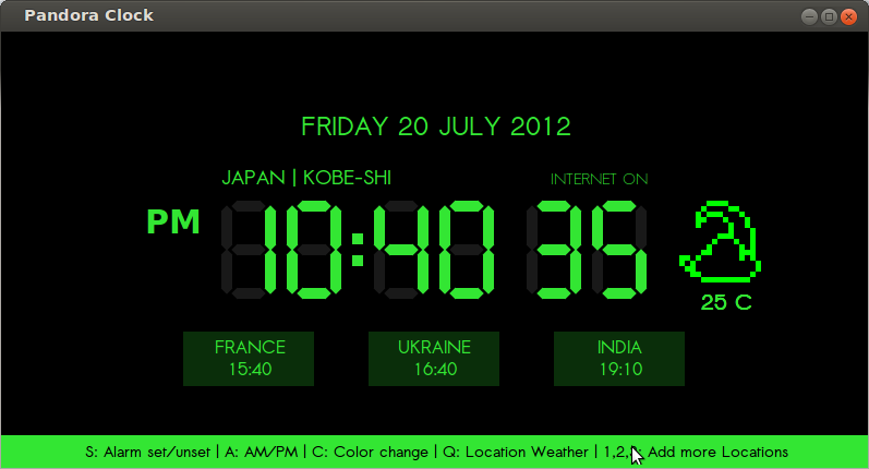

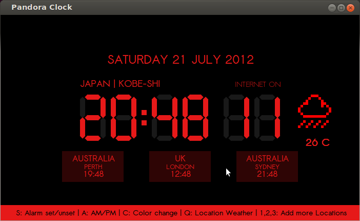

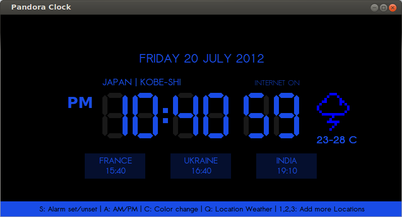

Features:
- Simulates old LCD-style alarm clock for time display
- Can display AM/PM time
- Enable color change of display / Red / Green / Blue / WHite
- Displays the day / month / date / day of the week
- Get weather at your location for today / tomorrow -
- Gets current temperature and tomorrow's temperature range
- Alarm clock with ringing sound
- Can add up to 3 different cities/countries to check the time difference (needs internet connection)
- Detects internet connection and updates weather information on regular basis (needs internet connection for weather info)
- Correction of time zone for US / Australia / China / Russia (several time zones in same country)
- Display city in other geographies
- Sleep mode diming the screen after a while
- Catching internet errors in data request
- Automatically saves any change in settings
- Automatically loads your latest settings at start
- Fullscreen mode possible.
How to use:
- Please refer to help bar at the bottom for shortcuts !
Appreciate if you have feedback / bug reports!

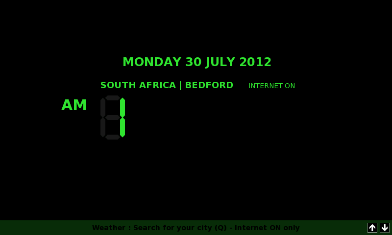

Tested one last time with Firefox open again, when I try to fetch weather, it hangs on this screen:
No not downloading anything while testing.

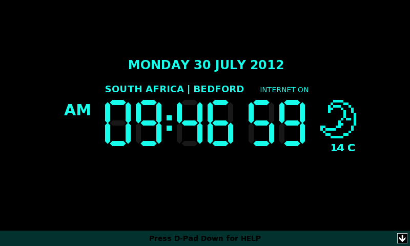

As for the color I would like to see, I think this would be perfect: :) !
As for the country I live in, it's South Africa. :)
