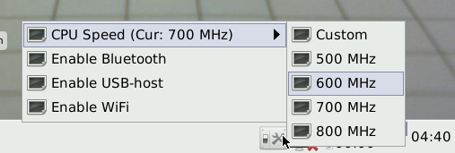

A small tray icon that lets you set bluetooth, WiFi, USB host status and change the CPU speed. I was unable to get CPU-speed and usb-host toggling working as a regular user, so for now, you'll need to enter your password.
In its final release, it probably won't be a PND, as EvilDragon expressed interest in bundling it with the stock OS.
Plugins are dynamically loaded. If you want to make a plugin, use the header in include/ from this repo.
Afaik, all plugins *should* work, apart from the icons (I'm too lazy to find suitable icons, I'll leave that to whoever finds them needed,) but that's why I release it for beta test :p

Have an option to toggle the status of each of the icons on the main tray ( ie have more icons placed beside the spanner icon ), eg I would show speed and current wifi connected, but not bluetooth.
It's entierly possible for them to share the same plugins as well, the plugins mearly provides a struct with label name and path to an icon.

* You mention in your instructions that I should send you absolut paths for the icons. So are these paths hardcoded into the system? Maybe a config files with links to the icons would be better (then everyone could change the icons). Or maybe hardcoded default icons with override via config possible?
* One of he most-wanted reasons: Since this now is a program in a tray and not just an icon, how about showing dynamically the current CPU-Speed and Wifi/BT/USB/TVOut-Status (using red and green LED symbols)? Would be a neat addition I think.
