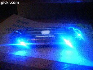

Hey!I'm Ryan Dardis aka ryan0/ryandardis/moncreef,but mostly ryan0!As a former Team Acidmods member I'm huge into hardware and software modding games consoles (modchips,sound reactive lights,cold cathodes,and alot more that you probably wouldn't believe me if I told you).I heard about the p&|a recently and thought it was too good to be true!turns out its' even better XD!Anyways I'd just like to get your opinion on something,but I should probably show you guys some of my previous work before asking you,so here it is!:
and here is a video:
http://www.youtube.com/watch?v=DMAo2kyP2WQ
(sorry for bad video quality)
heres the list of mods done to the psp in the video above:
power LED swapped to blue
Charge LED swapped to white
Transparent faceplate
custom jewel installed
6 uv led's put into jewel
2 green sound reactive (dance to music) led's under the dpad and face buttons
1 green led in trigger
2 blue led in other trigger
So I ask you this...are you guys actually interested in hardmodding your pandora and want me to write tutorials on how to hardmod the console,or are you guys just fine with software mods?
If you do not know how to solder but really want to do this,don't worry,I am writing some great tutorials on how to solder that will be up on my site soon (link below)
If enough people are interested I will buy a pandora and port these mods over to the pandora and show you step by step how to do them.
I've started up my own console modding forum for those who want to learn how to do things like this to any console,the address is h2m0ds.com.The site is still well in its infancy and under construction,and most of the tutorials are in the process of being written,so don't flame about it :lol:
