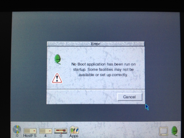

When I try mount a game ADF image such as Lander.adf or Elite.adf and access the floppy drive I get "disk drive is empty" error. Same as Martin.
Does it have anything to do with the above error?
How can I copy the ADF's to the Harddrive/HostFS and access it from there?
