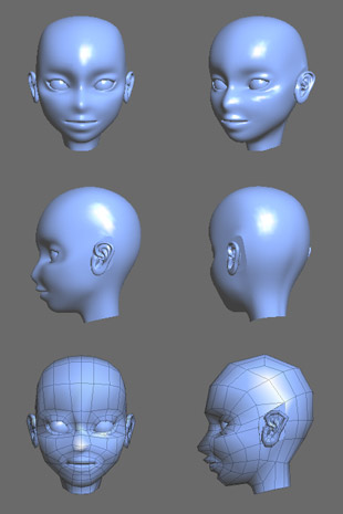

Second it allows me to revise my plans for a 2D game and make it 3D with retro styling. Viability is up in the air but I'll come back to that later. Plans are to create a top-down view 3D world along the lines of Ragnarok Online, except with cell shaded and outlined, normal mapped 3D characters and enemies. I'd do my best to add some pixel shadery goodness to get that delicious retro styling we all love, so that shouldn't necessarily be a concern.
One practical reason for a switch to 3D is simple workload. It takes a lot of time to animate pixel art. More time than it does to rig and weight a 3D model. And once you have say, the human characters bones animated, you can rig them to anything and hey presto, your work's done. With 2D you have to reanimate every item in the game by hand, which stays a lot of work and the thought of adding in extra animations later in development quite frankly horrifies me in terms of workload. It's just no good.
Another is that I've been programming 2D graphics for a long long time and I'm pretty bored of them. Back when I started PanMMO I didn't really know anything about 3D graphics, but I've since brushed up on it using XNA. I know enough to write my own shaders now and get a game off the ground. It also keeps working on the client's graphics fresh for me since I've been coding 2D graphics forever and I can pretty much do it in my sleep now, but 3D graphics is new, challenging, and interesting.
It also gives me a chance to work on my sorely neglected 3D modelling skills.

This MMO sounds awesome, I'm sorry, I haven't been here this long, care to fill me in on a couple things, like, what sort of MMO, gameplay, etc.? That head is very impressive, nice work!
