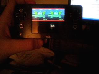

So I've got another PicoDrive issue. Basically all was going well, I haven't change much other than the "Don't save last used ROM" option, and another user suggested I make all my ROMs read-only to maybe prevent them from being tampered with (or deleted) so anyways... again all was well... then I turned on my Wiz one day and saw this. See picture below.
Any idea whats going on here? Haha... the screen was split with the Genesis ROM being displayed twice on the top half of the screen running super fast and the screen was discolored and weird looking. I simply deleted the emulator and reinstalled it on the same SD card which corrected the issue, however, I'm tired of having to reinstall this emulator.

Make sure your renderer option is set to 16 Bit, the 8 bit mode makes the framebuffer nauseous. =P
Alternatively you can delete *.pbcfg (I think, latest versions no longer use those).
About files being deleted, PicoDrive doesn't have means to do that, this probably happens because of missing sync() somewhere, not everything gets written to the card and filesystem gets corrupted. Might also be a dodgy card. Setting files read-only will not help, try always exiting the emu and waiting a few seconds before you power off, so that all writes to the card properly finish.

Deleting the .pbcfg worked... but isn't that the file that saves the custom options per game? I was saving custom options for those that were six buttons so I didn't have to remap everything over and over... should I not be doing that anymore? Also I have not been returning to the menu before shutting down I'll have to remember to do that.
