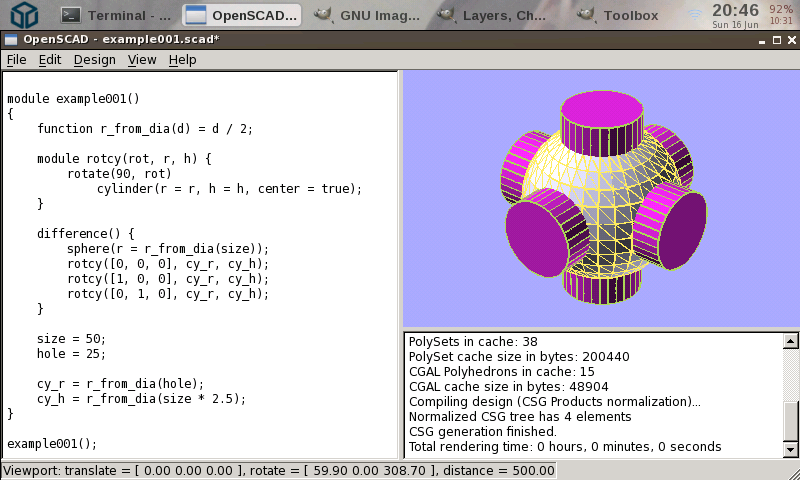

A shot of my version

I'm getting there... it runs on my Pandora - no idea if it has all features it needs to have (probably not, it complains about needing OpenGL 2.0) and if it is behaving fully correctly (I did some nasty things like disabling checks that complain about stuff instead of trying to figure out why it complains and fixing it). But at least something seems to work.
Now it's only a matter of packaging the thing up in a PND. It's going to take some time and effort to make that work, with all those dependencies.
I uploaded a PND to the repo. Please give it a try!
I managed to keep the PND size small despite all the dependencies by only strictly including what is needed to get something running. I wouldn't be surprised if I forgot to include something...
