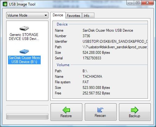

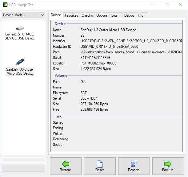

Under Windows i would unpack this Image from 7z and write the IMG File with a Tool like USBIT from here:
to an SD Card.
Maybe your Pyra will boot from this SD Card then.
