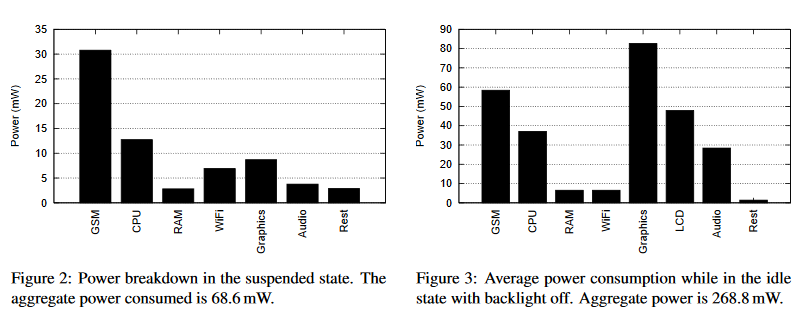

I was thinking about the Pyra and about when society collapses. We're getting solar panels with accu to store electricity but I need a device which I can use to play rogue on when society collapses. I was thinking that maybe a 2 RAM Pyra would be better due to it having less power consumption while rogue is being played on it. But I'm not sure how much the difference is. Is there any information about Pyra power consumption? Will it also be possible to underclock the Pyra in order to save power?
My first thought would be: Is power consumption by RAM a problem?
It might be a small issue for having the unit run on idle for long periods but when the Pyra is in use the RAM isn't the largest consumer of power.
Having the LCD backlight use a bit less power probably already negates the RAM power usage, then having more RAM is probably better as you can't add some more RAM when you need it while you can still produce some more energy.
Here is an older report for power consumption in a mobile phone:
As you can see the RAM is probably not the largest consumer of power in a mobile device.

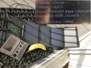

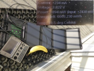

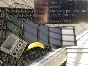

There are portable solar panels without charger, they could power the Pandora.
As you can see, I had enough power to run the Pandora, AND to charge it at the same time.
Just start building a faraday cage if you are worried about your electronics.
You lie !! It's visible that the cable goes through the banana !! I want too a banana powered Pandora !!
Some electronics can't handle charging by solar panels well, especially at no to low voltages, and usually a solar panel provide more then 5Volts that USB uses.
That's why there usually is special charging circuitry for solar charging.
You can charge a Pyra with multiple banana's if you want to, but it's not really efficient:
Probably better to eat the banana's and use the hand-crank USB charger.
One scale starting at 35 the other at 90 tho, how annoying to compare.
That graphic card spike tho...
Ive done a few tests on the pandora back when i wrote that book reading tool, the graphic card power consume heavily changes depending on what programs are open, and i mean open, not running or displaying anything.
Just opening a window without any refresh or cpu activity, having the program just sleep for a minute increases the power usage.
In perspective that means simply having a clock shown on the desktop probably has more impact on power than the amount of ram you have.
Caveat: The average mobile device uses LPDDR RAM. The OMAP5 variant that was supposed to support it was cancelled, we are using the much more power hungry common DDR3 RAM.
There is a obviously a difference in power consumption between DDR3 and LPDDR3 but I can't find any real numbers on what the actual differences are. It appears to differ per brand, implementation and usage by the product.
What I did read is that the biggest difference is in stand-by time, so shutting down the Pyra instead of putting it into stand-by might be a good idea.
One of the last firmware updates for the Pandora included the removal the active LED from stand-by to extend stand-by time. From this I assume the power consumption from an active LED is in the same range as SDRAM idle power consumption.
