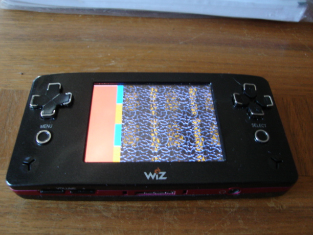

Check joystick...MES_MLC_SetLayerPriority.829: MES_ASSERT error
I changed to the "older" (yeah, I know what you think ;) ) libopengles from the archive and now it works. But the same problem as the glquake alpha: Black border on the right...
Pickle said:
Jan-Nik said:
How did you manage to link against libopengles_lite.so?
I tried to fine the link, but someone modified the library to remove VFP from the header, after that I could link directly.
Do you mean this one? http://watteimdocht.de/jan-nik/libopengles_lite.so

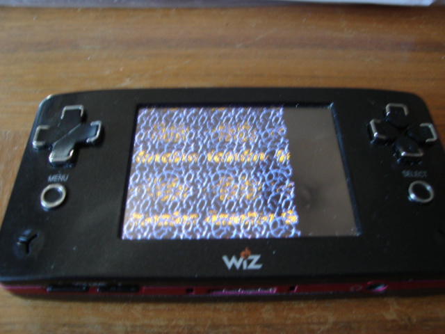

I've tried the nehe examples, but first it complains about a missing version in libgcc.so.1. After copying your version to /lib/libgcc.so.1 it works.
One problem though: Only about 70 % from the left side of the screen is visible. And after exiting an example i can only see about 30 % from the right side. (hard to explain)
Maybe it's because I'm still using firmware 1.0.0?
edit: Okay I've just read that this is a known problem ...
Yes, I think this is a problem with 1.0.0.
[Edit:] No, seem to be present with 1.1.0, too:
Yep the border thing happens to me too, I think its cause the screen isnt being rotated.
The other problem is that it seems the driver doesnt unload or reset properly so the second opengles app locks up, at least me
