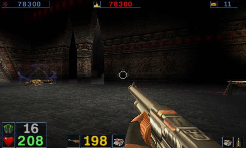

Here is Serious Sam: The Second Encounter (without data)
You'll need to copy the data from the original game (Steam, GoG or original CD version). Copy all the ".gro" files and all folders (but not the Bin one) in apddata/serioussam2 to play.
The game use gl4es, and use the recently opensourced Serious Engine 1.
The game runs ok on Gigahertz model, but is more demanding than the First Encounter. FrameRate are globaly a bit lower, but still playable. It's advised to use the latest SGX Driver for better performance and stability.
Some preconfigured config are there on first run, but fell free to play with the various parameters.
