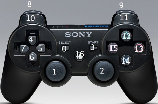

This will be very helpful for those configuring their controllers with an emulator:
EDIT:
It looks like rumble support from qtsixa is on by default. Enable rumble in mupen64plus, change three variables in InputAutoCfg.ini under PS3 section
plugin = 5
Mempak switch = button(0)
Rumblepak switch = button(16)
The PS button will switch to rumblepak. Select button will switch to mempak and disable rumble.
Only downfall to the rumble feature is it seams to be over-aggressive. Rumble aggressiveness/sensitivity may not be translating properly, any little bump sends the rumble motor(s) into overdrive.
