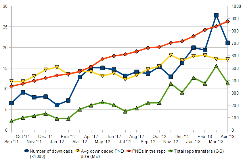

Here is a chart from _wb_ (thanks):
The blue and yellow lines correspond to the left y-axis.
The orange and green lines correspond to the right y-axis.

Here's the above table in a graph. The blue and yellow lines correspond to the left y-axis, the orange and green lines correspond to the right y-axis.
