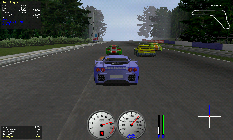

Here is T.O.R.C.S, The Open Source Racing Car Simulator
This port use glshim.
Some warnings:
  1. It seems they maybe some slight issue due do FAT32, so on first launch, it just doesn't work. But it will on 2nd launch.
  2. The game is a bit slow on the Pandora. It's mostly ok (especialy on Gigahertz model) on Practice (when you are alone), but tend to crawl in Race when you have more A.I. cars. So you should limit to 1 or 2 opponent to keep framerates ok. : fixed with build 02
  3. The minimap works sometime, sometimes not. Don't know why. : fixed with build 02
  4. Remove the Mirror (with '9') for better framerate. Change view to inside view with no cockpit also for a bit better framerate (with 'F2' 3 or 4 times...).
  5. There are some precision texture bugs clearly visible, but fixing that seems difficult, has it has to be done globaly for all texture coord of the landscape.
  6. Default controls are set to Dual Nubs: Left Nub for turning, Right Nub for accelerate/brake. This can be changed in options sceen. All Pandora Button should be accessibles.
  7. While Playing, you cannot change focussed car. It used to be PageUp/PageDown but it conflicted with Pandora Button (if you want to put Throttle/Brake on them) so I remove the function.
  8. Some Circuit are more graphicaly intensive than other, I changed default Quickrace because "Forza" is one of the most demanding one. : fixed with build 02, Forza is perfectly playable now
If you don't like Dual Nubs mode, you can change left_nub and right_nub file in appdata/torcs. Put "mouse" and "mbuttons" inside (without the quotes) to get the mouse back. You will have to change the configuration for the player.

Ah yes, it just silently exit. I should have precised it. It should runs on a CC (I tried and it worked). But be easy on the A.I. cars you add in the race. I think an 1-on-1 is the max a CC can handle with enough fps for it to be playable.

I tried to make it run with the Framebuffer mode, but it's defenetly not compatible. I have to check in the code, but the way it update the screen and do the Swapbuffer makethe game play completly garbled, or the menu are unusable. It looks a bit like Blender, doing only partial update.
New build on the repo.
I used a newer GCC (v5.0.0 experimental), with agressive optims (especialy the new lto), and with newer glshim, the game is *much* faster.
In fact it is playable on CC (without a swap) with 3 A.I. on the default race now.
Also, I change the way the mirror is rendered (from glCopyTex to FBO rendering) making the game compatible with pure Framebuffer rendering, so it's now compatible with 4.10 version driver for the Gigahertz model.
Like for build 01, on 1st launch, it doesn't start on Fat32 SDCard. It works on 2nd start.
Also, default is still Dual Nubs mode (left nub to steer, right nub for gaz/brake). If you don't like Dual Nubs mode, you can change left_nub and right_nub file in appdata/torcs. Put "mouse" and "mbuttons" inside (without the quotes) to get the mouse back. You will have to change the configuration for the player.
