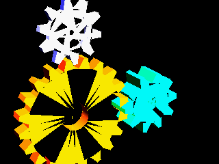

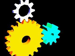

I got the pspdev TinyGL code compiling and running on the GP2X.
Compare this in floating point as a straight compile of the original TinyGL code at 10fps
to this compile of the fixed point version from pspdev.org at 11fps
Same compiler options. Same linker options. All the same problems as the original TinyGL code (odd lighting mainly) plus a whole load of polys that aren't drawing for some reason, and only 1fps faster.
