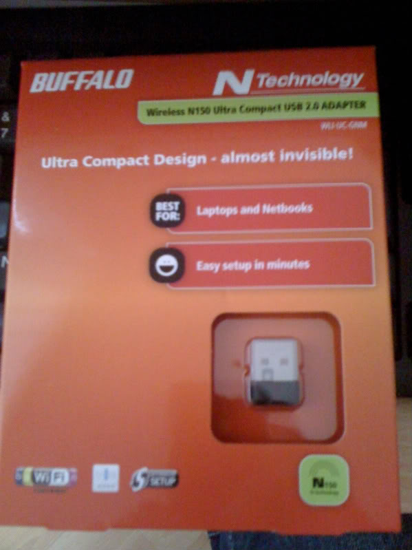

I just got my BUFFALO Wirles N150 ultra compact WLI-UC-GNM through the post and it has the right chipset but its not working on the Caanoo this thing is tiny man love it my firmware is 1.5.0
Looks like we have the same problem dude :(

According to this forum it is a Ralink chipset
http://forums.opensuse.org/english/get-help-here/wireless/447246-buffalo-wli-uc-gnm-wireless-n-driver-opensuse11-3-x86_64-a.html

Well it turns out my adapter is a Ralink RT2870v chipset which is newer than Viranimus Invictus`s.. Rikku was helping me to sort it out
But I havn`t as of yet - Im not giving up hope yet maybe some clever dev will make a driver that wil work with loads of dongles in the future
ruffnutts ;)
