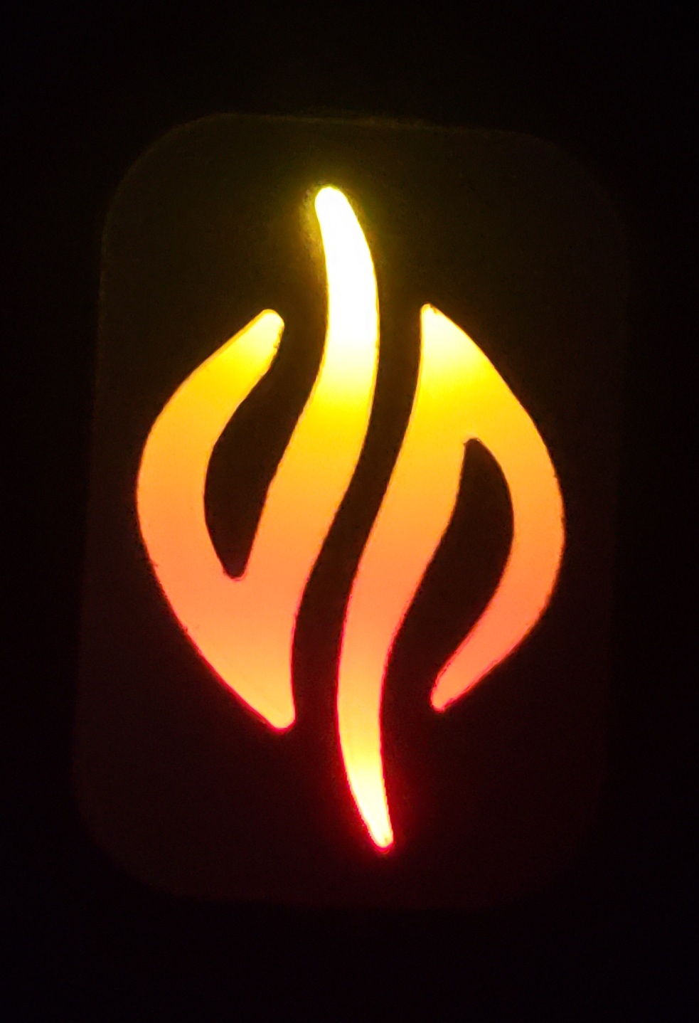

I don’t even know if this was just the normal colors or it was because of the scrippt
The original colours are red. I did include a summary of what the colours would be after the script was working.
Summary. Bottom logo will be red discharging, yellow charging.
Discharging, top goes green (99%-50%), yellow (49%-20%) then red.
Charging, top goes red (0-49%), yellow (50%-79%) then green.

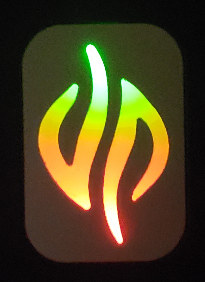

Thanks for the Answers, i think this works now as my Lid Logo is now Red and Green whyle i write this on the Pyra..
I plan to use now my Pyra for Internet on the Go to see what happens under a certain % ..
and i have to charge whit OS on to have the Colors..

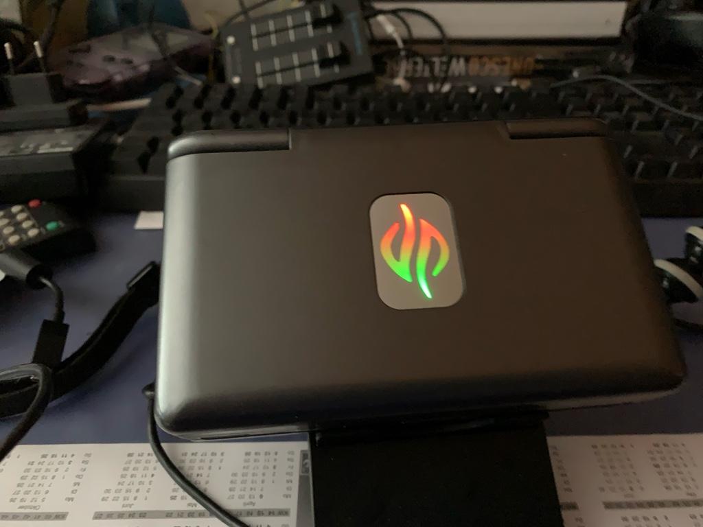

It’s now looks so when I have the os running, the lid closed and the charging cable in:

I dont even know if this works now, i get this Color Sheme when the Pyra is running, and as im over 60 %, this should be look how it was meant, but i ditnt brought the Pyra to under 50 % Yet as somehow the Monday was not the day for this experiement..
