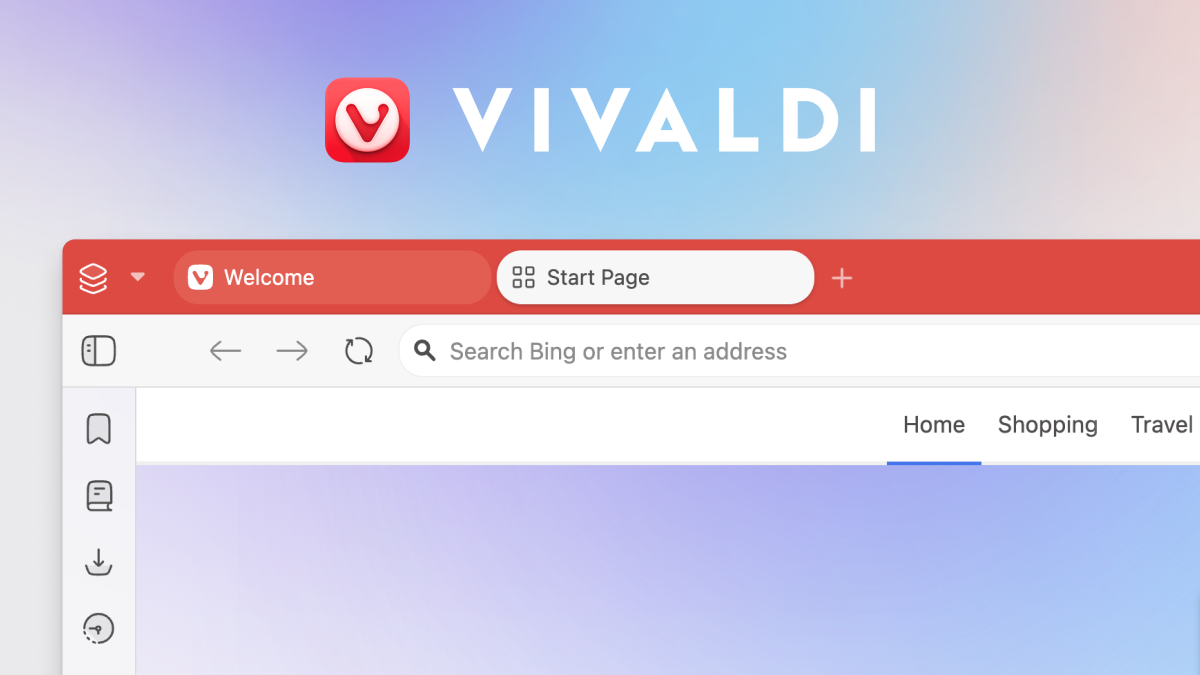

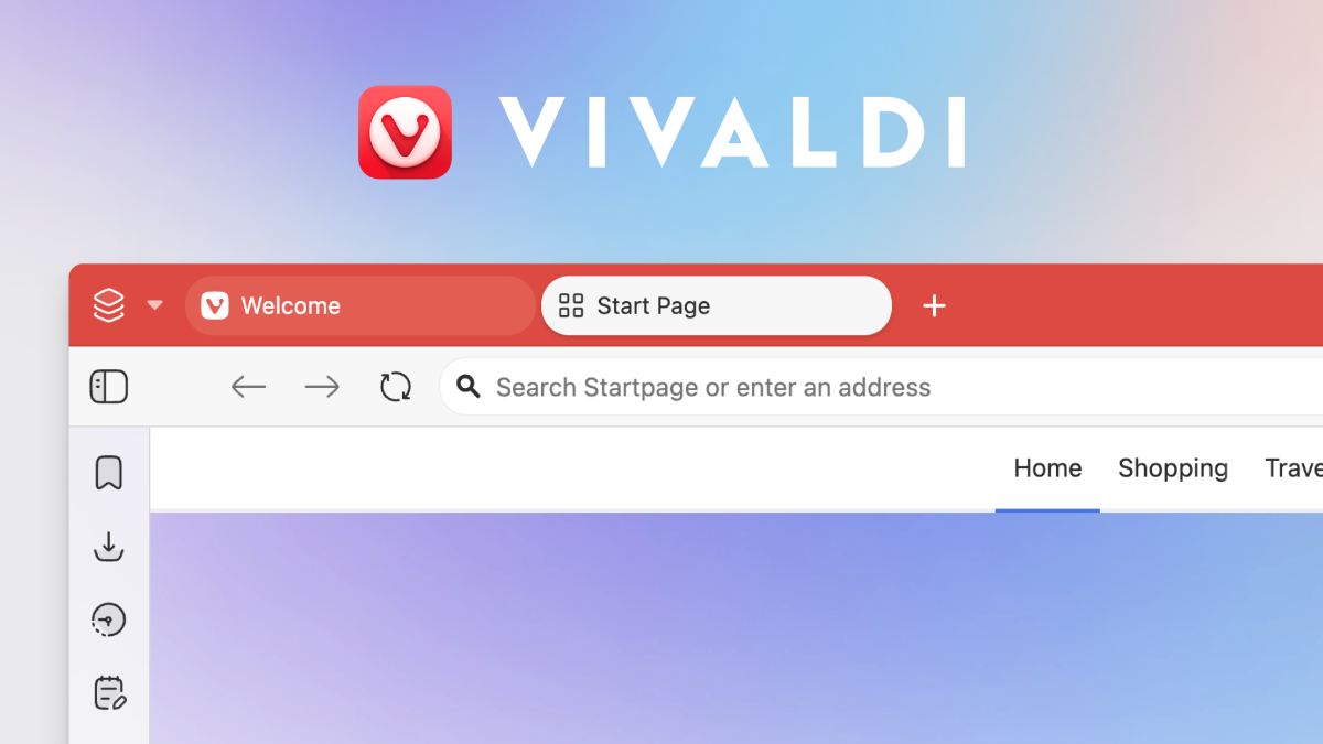

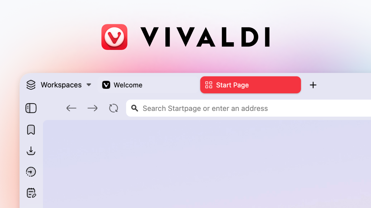

You surely want to install a web browser. One of the fastest browsers for the Pyra is Vivaldi, which is not included in the debian repositories and has to be downloaded sperately. (https://repo.vivaldi.com/archive/deb/pool/main/)
Then navigate to the folder and run
$ sudo dpkg -i vi... (hit tab to get the full file name)
TIP: Keep the deb-file in case you want to setup a second OS on SD card!
TIP: Get used to switching browser tabs with CTRL (R1) + PgUP (Y) or PgDn (X) and keep in mind that you can use the F11 key to switch the browser to fullscreen mode. On a small handheld device, this will greatly improve your browsing experience!
