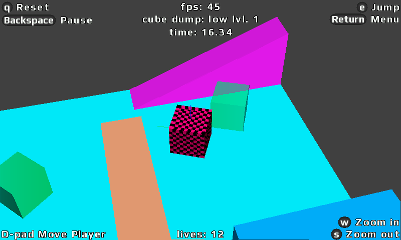

So I get better framerates now (I just changed in main.cpp, the "framerate" from 10 to 20, to cap @50fps).

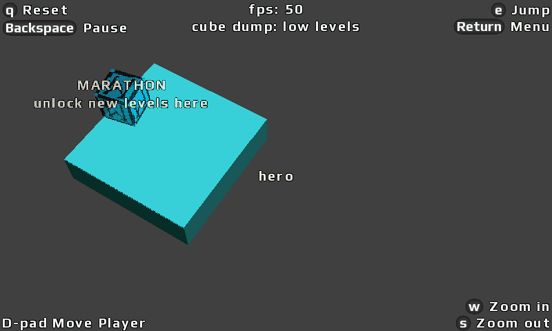

I thing there are some pb with the levels, I don't exactly get the same things as in your video (look at the screenshots). In the level selection, the "ground" seems to small, the hero is not there. I used the menu to get to next level. I works (I have difficulties to jump on the blue plateform, but that maybe just me, but it seems the hero is not jumping as high as in your video).
Still, it move nicely on the pandora, but I think the timer is ticking a bit too fast.
Yeah, the timer should be roughly going in seconds, so something is probably going on there with my conversion.  Perhaps that is a question to ask to Ziz.  I convert from Sparrow3D's Uint32 steps (in the update function) to my float dt via dt = steps *1.0 / 1000.  Doing some tests on my computer, that seemed to give dt in seconds.  Perhaps the conversion factor is something platform specific...
And the hero should clear the floor by around 1.5 times her height when jumping.  If there's something funky with the time, then that might be messing you up.  Otherwise, try to get a little momentum before jumping, because you can't change your momentum in the air.
Not sure at all what's going on with the menu level, why the hero isn't rendering...

On the menu, I have noticed, by comparing with your video, that many things are missing. The hero (may be it fell?) and the other grounds with the numbered level. I only have the "Marathon" level here. Are the data files up to date on the github? I'll probably try to take a deeper look tomorrow on the Pandora.
Yeah, all the data files are up to date.  Levels are actually hard-coded into the cpp files in the dumps directory.  (See for example lvllow.cpp and lvlmenu.cpp for my levels and the level-select menu.)
Also... You have to beat the levels in marathon mode for them to appear on the level select screen.  That's why you don't see the numbered levels at first like you did in my video, because you haven't beaten the requisite levels in marathon mode yet.  It's to help the player feel like they accomplish something ;) .
If you beat a level in marathon mode, and it doesn't show up the next time on the level select screen, then something is wrong.  Let me know if that's the case!
