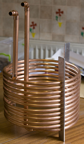

whiskey would be cool, maybe a future project with completely different equipment. What you see in the picture is just for the sugar extraction and cooking process of the beer brewing. I have 5 gal carbouys and buckets for fermenting. The yeast doesn't get added until the wort is at room temperature, for which I also got an immersion cooler, similar to this:
to speed up the cool down process as it takes a damn long time otherwise.
