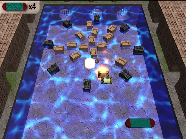

I'm releasing Briquolo 0.5.7. This include work from Pickle, paeryn and I. Most of the hard work have been done by paeryn. I feel like I'm just a release manager here ;)
Briquolo is a breakout initially based on openGL, but this release include GLES support too.
(it look better on the pandora ;) )
