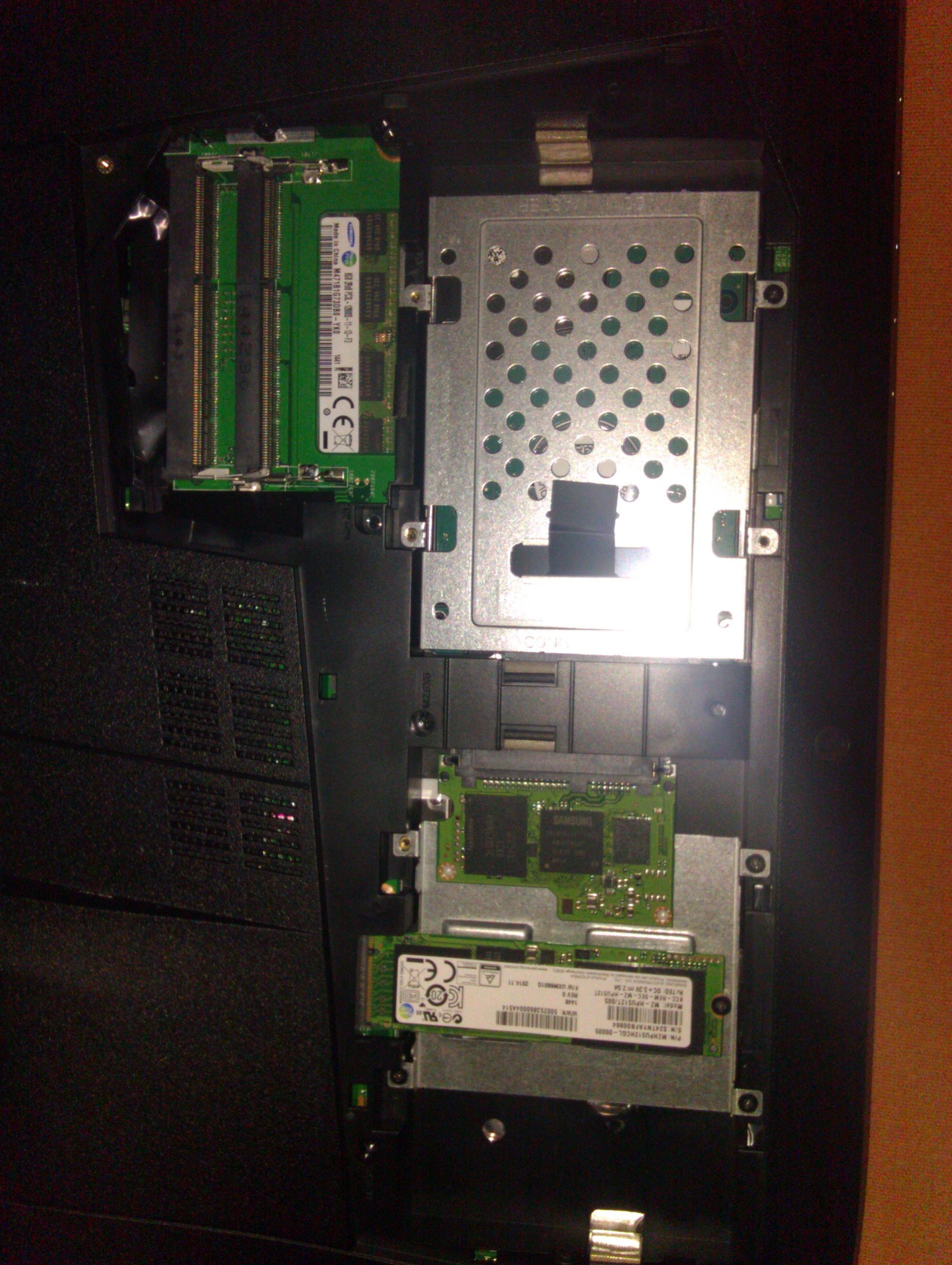

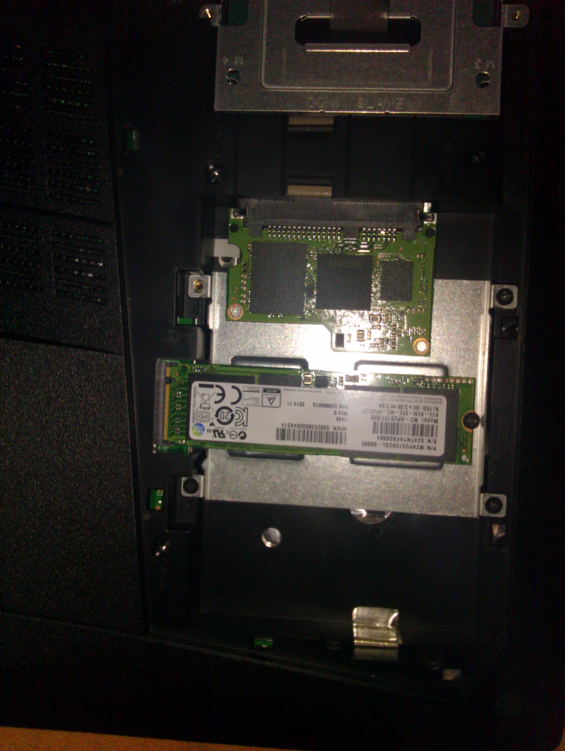

BTW, I have "modded " it a little...
Aaccording to the specs you can only use 2 of the 3 SSD slots at once. It has one M2 Sata port and 2 Sata 1 Ports. But only 2 slots for 2,5'' HDDs where one contains the M2 and a "normal" one.
That was the biggest downside for me. I wanted a separate Linux, a Windows and a Data Drive)
The Solution:
Never tell the guy who has 4 Shoulder buttons on his Pandora that something "doesn't fit".
I wanted to disassemble a common SSD and somehow tape 2 above each other.
Luckily storage evolves and needs less room.
The Samsung Evo 840 SSD motherboard needs the whole SSD case.
The Samsung Evo 850 SSD only needs about half of the case.
I was really surprised as I opened up the case and there was nothing inside...
I've attached 2 picture.
In one Slot are 1 M2 SSD and one dissembled 2,5" SSD. The small thing is NOT an mSata but a 2,5" SSD.
Works perfectly fine now :).
