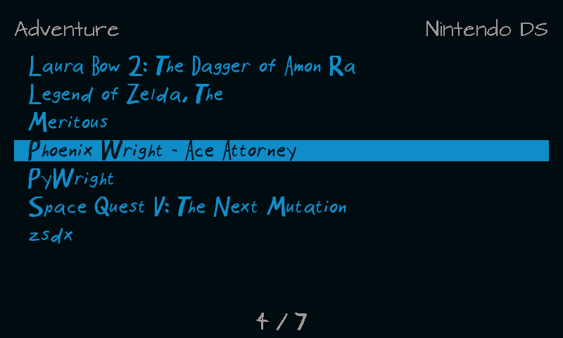

Pandafe is a sort of "universal" SDL frontend for Pandora games and emulators.
It was written especially for the Pandora, with the following goals:
* browse and run all roms and games from a single program
* specify commandline options for each game via a menu
* be fully configurable and extendable via the program itself
* use only dpad and buttons to do all this (no touching, heh)
* persist data via yaml, for human reading/writing/sharing
