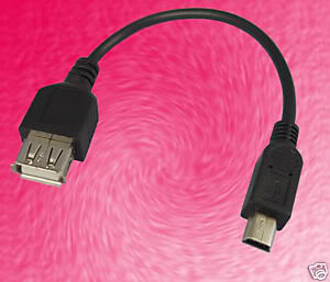

So it looks like for connecting something as basic as a mouse or external keyboard to the Pandora's OTG, we are going to need a micro-A-male - to regular-A-female adapter. From how I understand it, micro-B won't work because of the ID pin that is supposed to tell the Pandora to act as a host.
(Alternatively, we could use the EHCI port with a hub, which I guess is something we don't really want.)
Sadly, on the web I mostly found mini-B-male to regular-A-female, whatever these may be good for. Does anyone know a source for "real" OTG adapters?

Well, that's kind of my question. My guess is that it won't, since the different shape of the B should (according to the specification as I understand it) cause the Pandora to think it's connected to an external host, not to a device.

I have a 10cm long cable I got from conics.net when I bought my latest Zaurus, but I also recently received an extremely low-cost adapter from Dealextreme which also works perfectly:
http://www.dealextreme.com/details.dx/sku.26783
The shape is only to prevent it being inserted into mini-B only sockets which aren't capable of being used as a host. The crucial difference is the wiring of the ID pin in the plug to ground; I used that to fabricate host cables out of mini-B cables years ago when they just weren't available without paying a hefty premium.
Most of the cheap chinese cables don't bother using the mini-A plugs because they're hard to get - especially now that they've been effectively deprecated by the USB standards group.

I'm hoping this has the correct connectors
http://cgi.ebay.co.uk/Mini-USB-OTG-On-The-Go-Host-Lead-Cable-Cable-Convertor_W0QQitemZ180428424930QQcmdZViewItemQQptZUK_CE_GPS_Accessories_Software_ET?hash=item2a025f46e2#ht_500wt_1182
