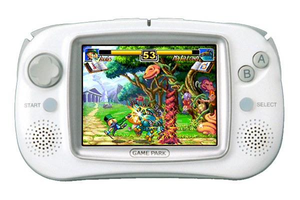

somone should make 2 extra buttons that plug into the EXT port and u can uses them in opensnes
I was thinking, the first time I started playing with MAME I used the old "hack a keyboard" trick to make a controller.
We could probally do the same with the chatboards, or find a supplier of the chat board chip.
also, does anyone know if the chatboards are a matrix or scanning device. (if you can press two buttons at once with out ghosting)
But the 2 xtra buttons will be "really far away" from the rest, making it impractical
nigelibrown posted on Feb 20 2004 at 02:37 PM said:
why not buy a usb keyboard for a PDA and use that? After all the GP32 has a host controller!
Unfortunately, the GP32 DOESN'T have a host controller. This is why there aren't any USB devices for it.
Link to another thread about controllers. We need a coder!
If you check the Samsung datasheet for the S3C2400X (chapter 12) you will find that the GP32 does indeed have a host controller! In fact the CPU has 3 USB devices 1 x slave and 2 x hosts. The slave is multiplexed to one of the hosts. All are Open HCI compliant. I think the only thing missing on the port will be power but that should not be a problem either.
I think the only thing that is stopping USB device development is the amount of programming required. perhaps someone out there is brave enough.
