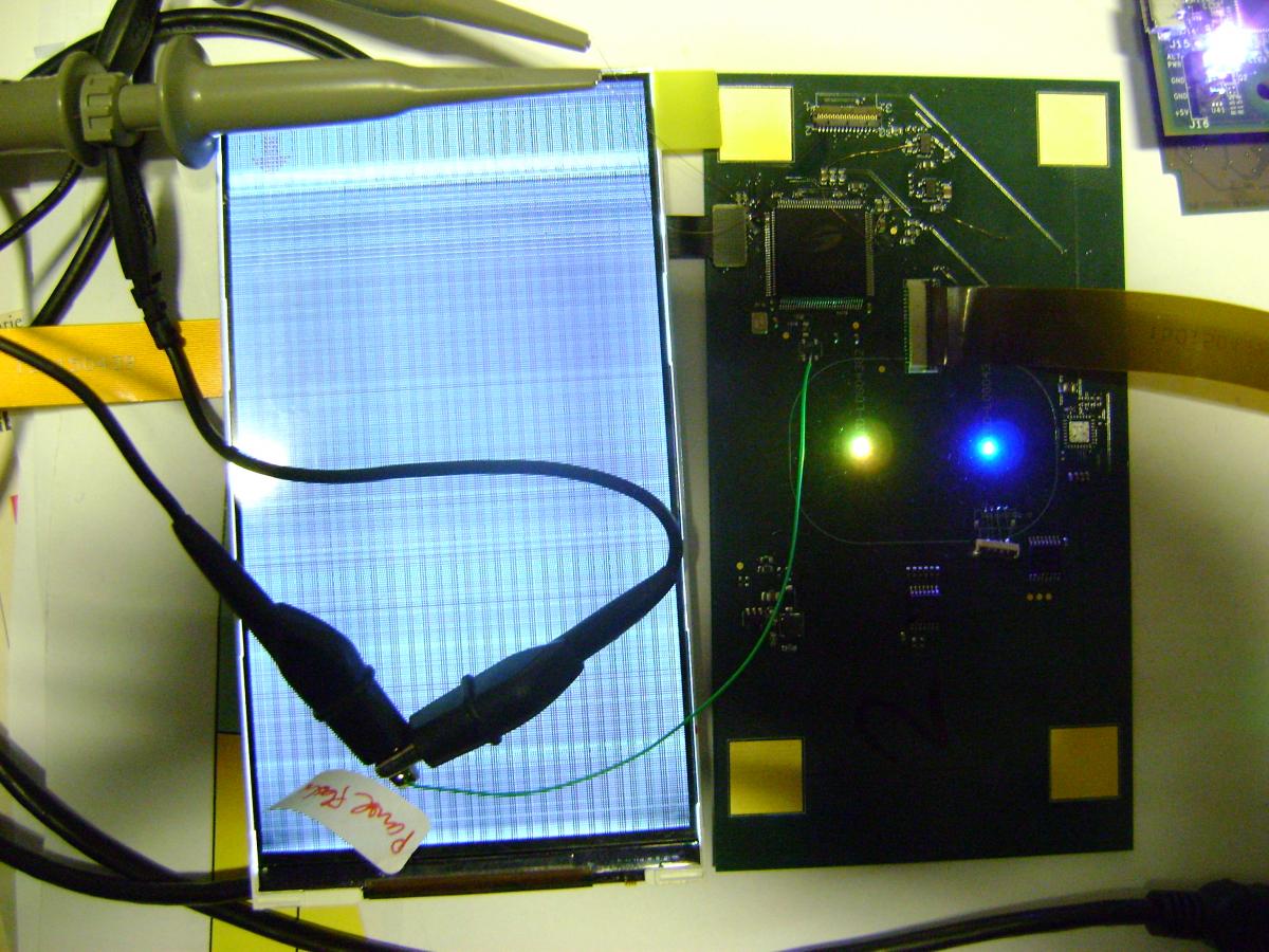

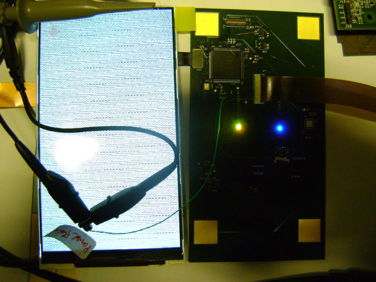

1. The Rotator chip
We've come a long way here, Nikolaus, notaz and the Solomon Tech team were working together and we're not too far away from having it working properly!
There are a lot of parameters that have to be set to make it work, but most of them are now set up properly.
The only thing we're still working on are the timing settings for the video stream.
Setting up the chip and rotation are already working properly!
You can see that on the pictures:
As mentioned, the video stream is not yet setup, so the display simply displays whatever random stuff is in the RAM of the rotator chip, but it's stable and the rotation is working properly as well.
Once the timing settings are correctly calculated and applied to the video stream, that chapter can be closed as well.

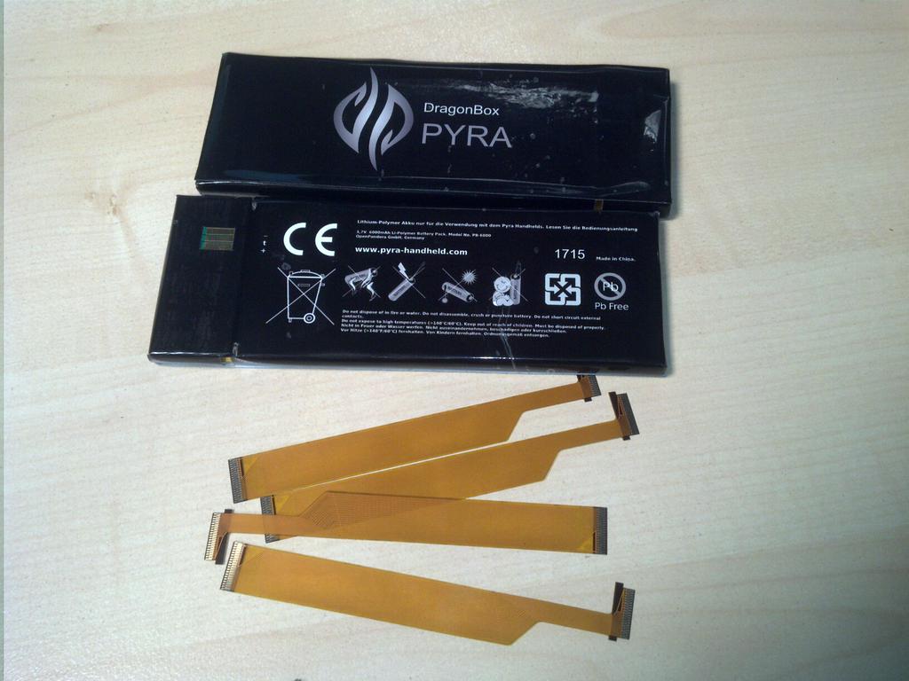

2. The LCD Cable
The LCD cable as well as the battery samples have arrived - unfortunately, we need to rework the cable a bit.
Connecting the panel leads to some video, but it's not stable and the display is flickering.
This is because it seems the traces are currently too weak for the power we need to send through them.
Nikolaus is currently measuring which traces need more width or thickness so everything gets through properly.
Apart from that, the cable looks and feels fantastic :)
3. The Battery
The battery fits nicely and doesn't wiggle around as the Pandora battery (so no padding needed anymore).
We've not yet run extensive tests, but it provides power ;)
As it's from the same manufacturer as the Pandora battery, we don't expect any issues here, as the Pandora battery has proved to be quite awesome :)

95% des Problems liegen wohl an der Verbindung vom EVM zur Platine (diese Verbindung faellt ja eh weg).
Wird das Mainboard extra mit Strom versorgt, ist alles schon deutlich stabiler.
Aber wir wollen es ja 100% stabil :)
