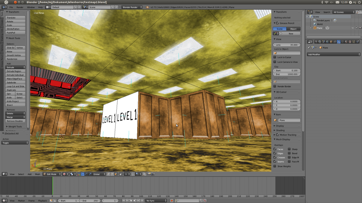

Heres an image from the test map Im using right now, when I have completed the collision detection and last rendering changes Ill make a new compile for Pandora and see how it runs then, and upload it here if anyones interested to have a look at it.
Will keep an eye on this and try it out as soon as you release a build. The colors on that test map remind me of some of the Wolf3D levels :)
