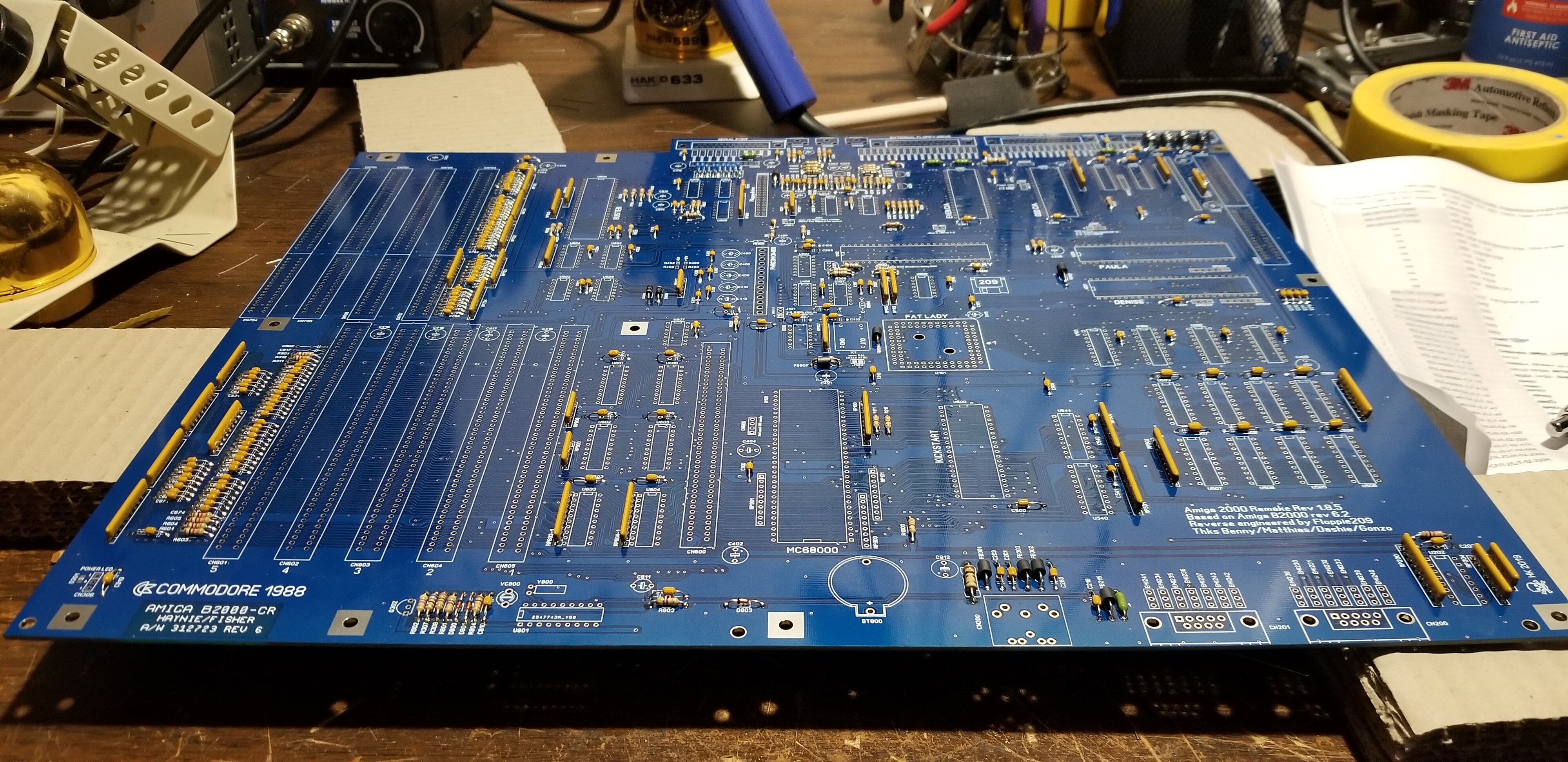

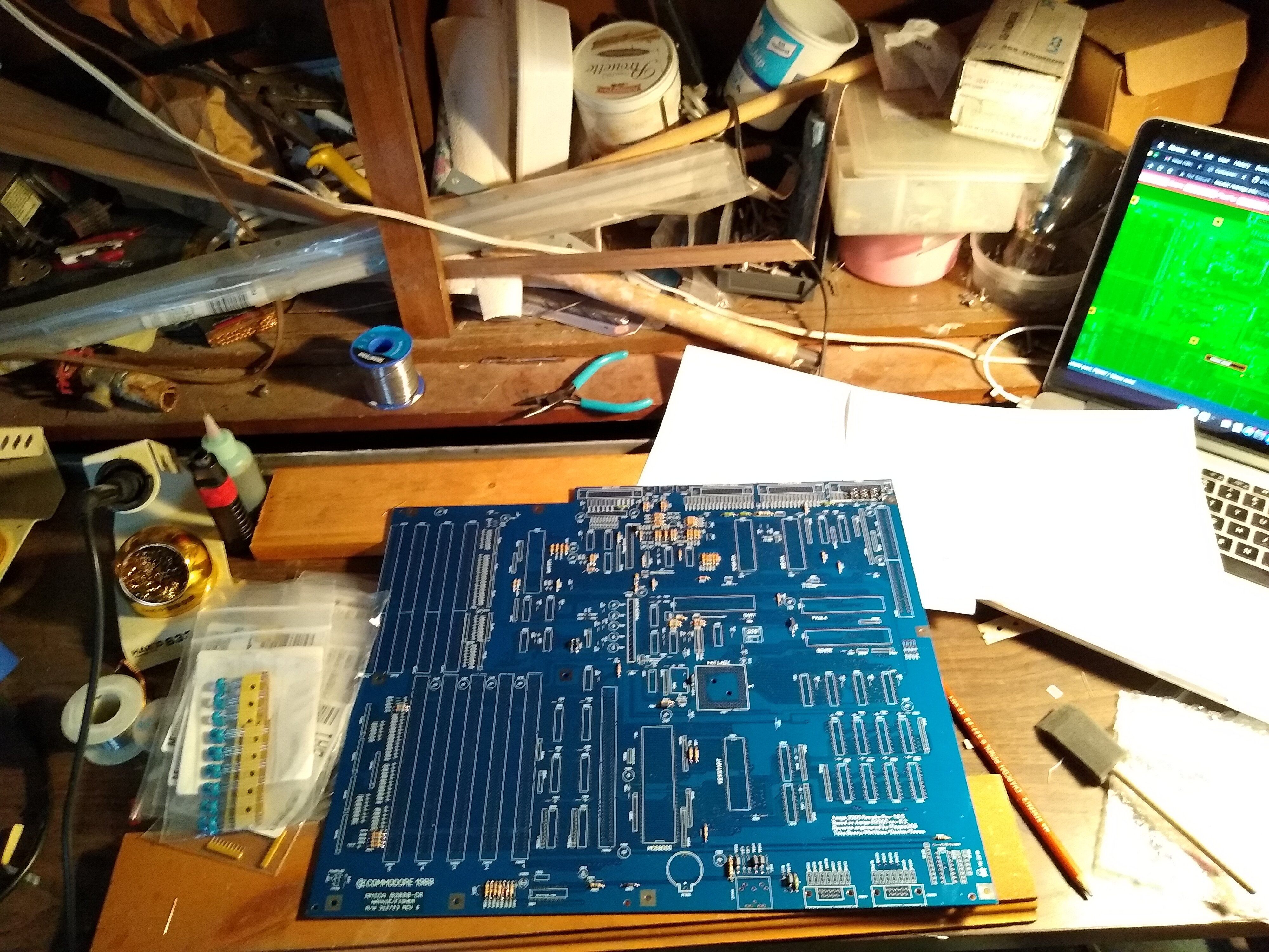

Started populating the A2000 PCB, so far it feels like I've done a ton work with just the regular resistors, diodes, ferrate beads and fuses, but it looks like I barely got anything done. This is already about 4-5 hours worth of work. I'm about to tackle around nearly 200 Ceramic capacitors soon...
Worked a bit on the project today, more components in, looks like I forgot to order some electrolytic caps, those coming in Wednesday.

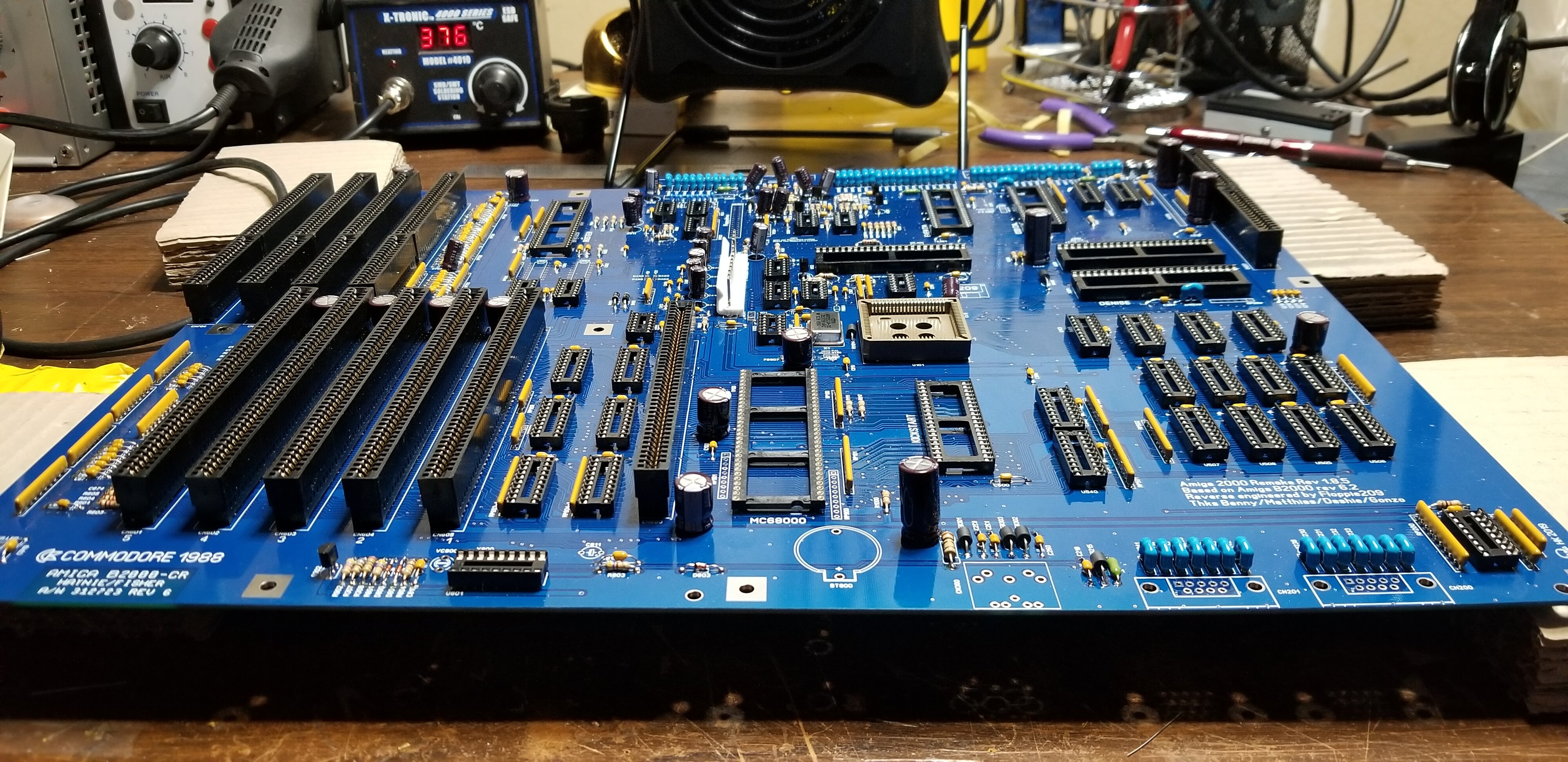

Potentially get IC sockets in tomorrow.

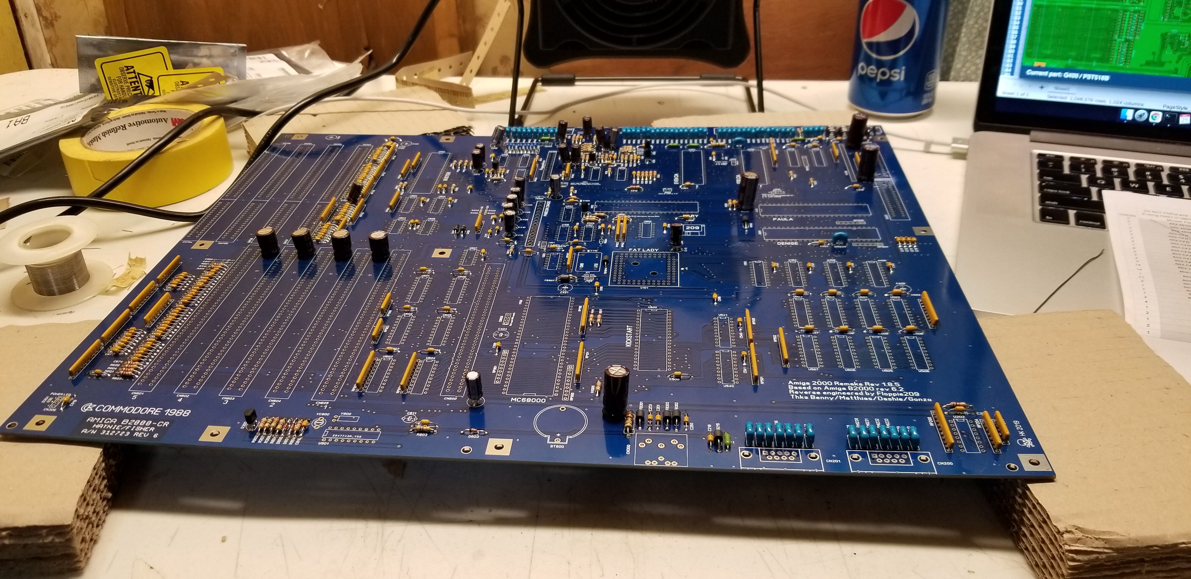

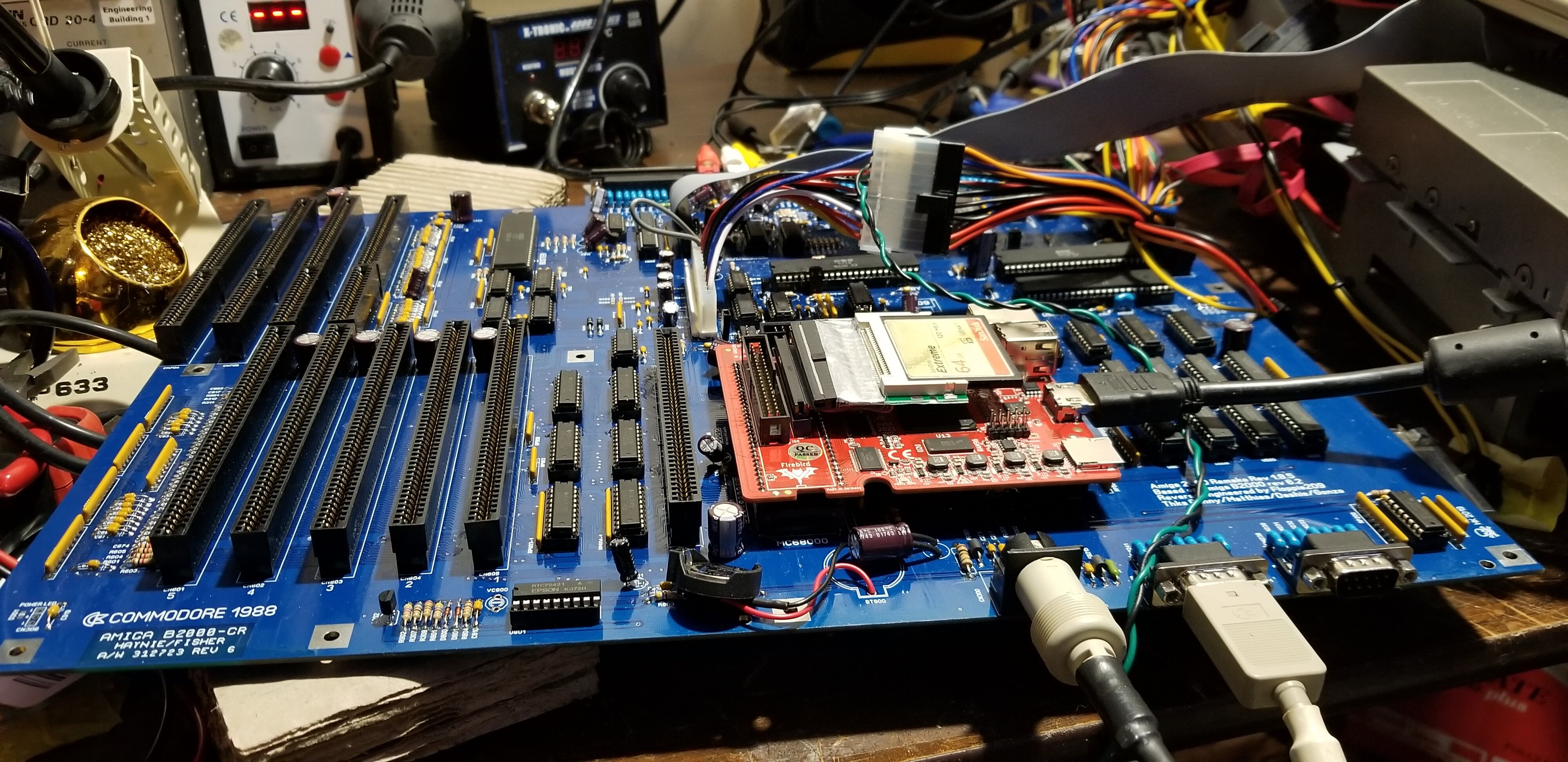

Made considerable progress as it was a Holiday weekend mixed with a winter storm that allowed me to have some time to work on the project. I have two IC sockets I need to come in the mail and the IC sockets are done. Also I have a slight alignment issue on one of the Zorro II bus slots, it bugs me, and I will address it later, but want to make progress on getting this working and it's likely a slot I won't use anyway. After test fitting the Firebird Accelerator It looks like I will need to move two of the electrolytic capacitors around the 68000 slot and the RTC battery location is in the way too, luckily I have a coin style battery socket with wires.

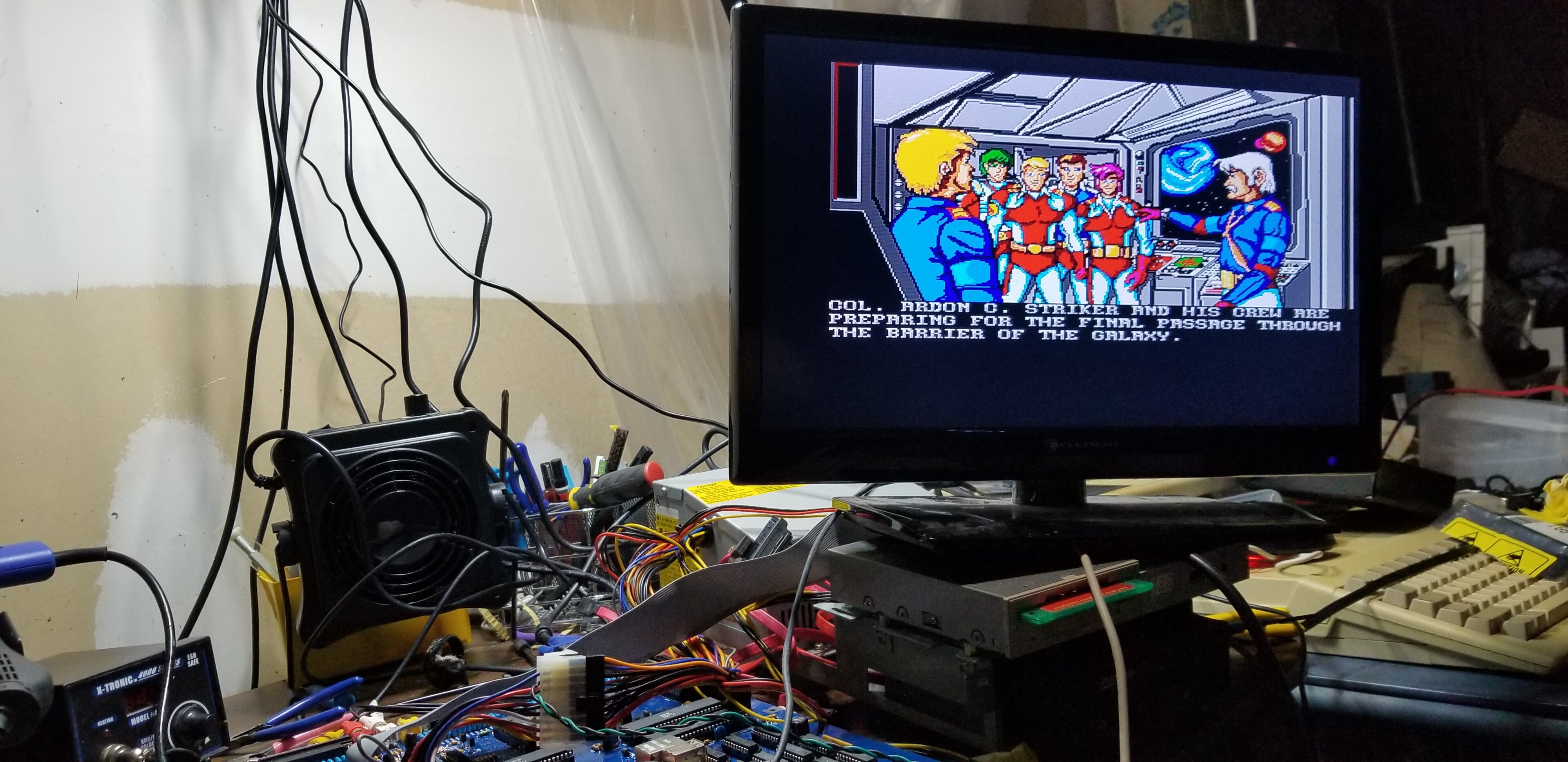

It lives!, still not 100% tested and still some quirkyness with either the OS or hardware... I need to run a thorough hardware test. But I have signs of life for sure. More to come.
I see the Vampire board on there. That's a big boost to any real Amiga!
Yeah that's their new Accelerator card, The Firebird. Not sure why they dropped the Vampire from their naming scheme...

I think I discovered a bit of the quirkyness, it would run for a bit and then just freeze up on me, with a regular Motorola 68000 I could only get it to boot every once an a while. I think the accelerator is bypassing some of the functions of the Fat Angus chip and allowing it to work in some capacity, just not properly.
After experimenting I could get better results by swapping out the Fat Angus chip with another one I had on hand and I could get to the kickstart ROM more consistently... However in the process of swapping out these chips I damaged the PLCC socket and cracked it... so I desoldered it and waiting on a new one to come in, Along with a proper PLCC chip extractor...
Few steps forward and some steps back.
