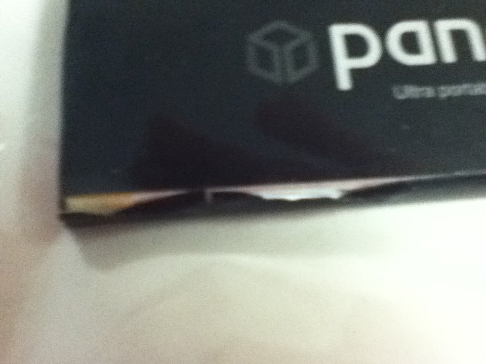

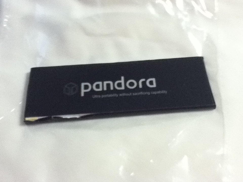

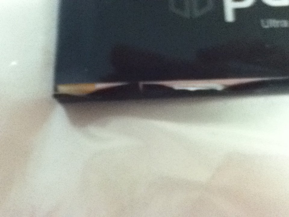

Prometheus talking about her battery label peeling raised some doubts, and looking at my battery when I took it out to dispose of it strengthened them. I have some pictures (which I should have taken from the very beginning, but it didn't occur to me) of the affected area, does it look like it's just the label peeling due to weak adhesive, or is it still a problem that makes the battery unable to be safely used? I apologize for the low quality of the pictures, and also the fact that they're upside-down.
I really should have done this to start with.
