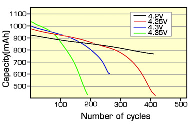

I found this image, it shows how the battery charge voltage effects the lifespan

Depends, If the (internal) charging system is designed to max charge to 4.10 ~ 4.15v and to consider the battery "dead empty" (device refuses to even start) at 3.0 ~ 2.9v then this is not a problem.
You can perfectly "discharge" the battery then because the "empty" level is above what will provoke damage to the battery.
It however "limits" the amount of charge you could get out of it to approx 90% ~ 95% of what you could get when going to 4.20v and 2.7v for example, but this will greatly reduce the lifespan of the battery, The little added "battery runtime" is IMHO not worth killing the battery :rolleyes: .
Would be nice to know what limits are set in the pandora (and this should ideally NOT be "user configurable" in anyway), so that if people use a external charger (or build one) they know what the pandora uses.
It would be nice to increase the safety margin, even at the expense of more limited charge, if that increases the long term lifetime. At least that would be nice for me. :)
