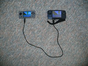

I needed this module to pull off dingoo <-> caanoo multiplayer (I'll emphasize more on future posts).
And I want to share the results of my work, incase anyone else has some cdc gadgets to connect to their caanoo. :)

Practically people can also use these modules for caanoo <-> caanoo wired multiplayer.
You just need to load the cdc_subnet module.

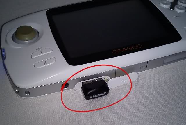

This little baby is the solution :)
Not really, no. The Dingoo hasn't got any usb host, wifi or bluetooth connectivity, we're stuck with cables.
P.S. I had that little thing already bought :p. I'd prefer having a newer kernel though.
