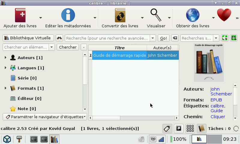

I'm progressing with Calibre.
I had to hack around dbus-python 1.2.x as it needed a newer version of DBus that the pandora has.
I finaly got the 1st screen wizard to show (it's a bit big for the screen, but not sure I'll do something about that).

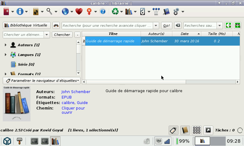

[doublepost=1459323027,1459322674][/doublepost]After changing a few preferences, choosing smaller everything, the GUI is a bit better for the small Pandora screen.
